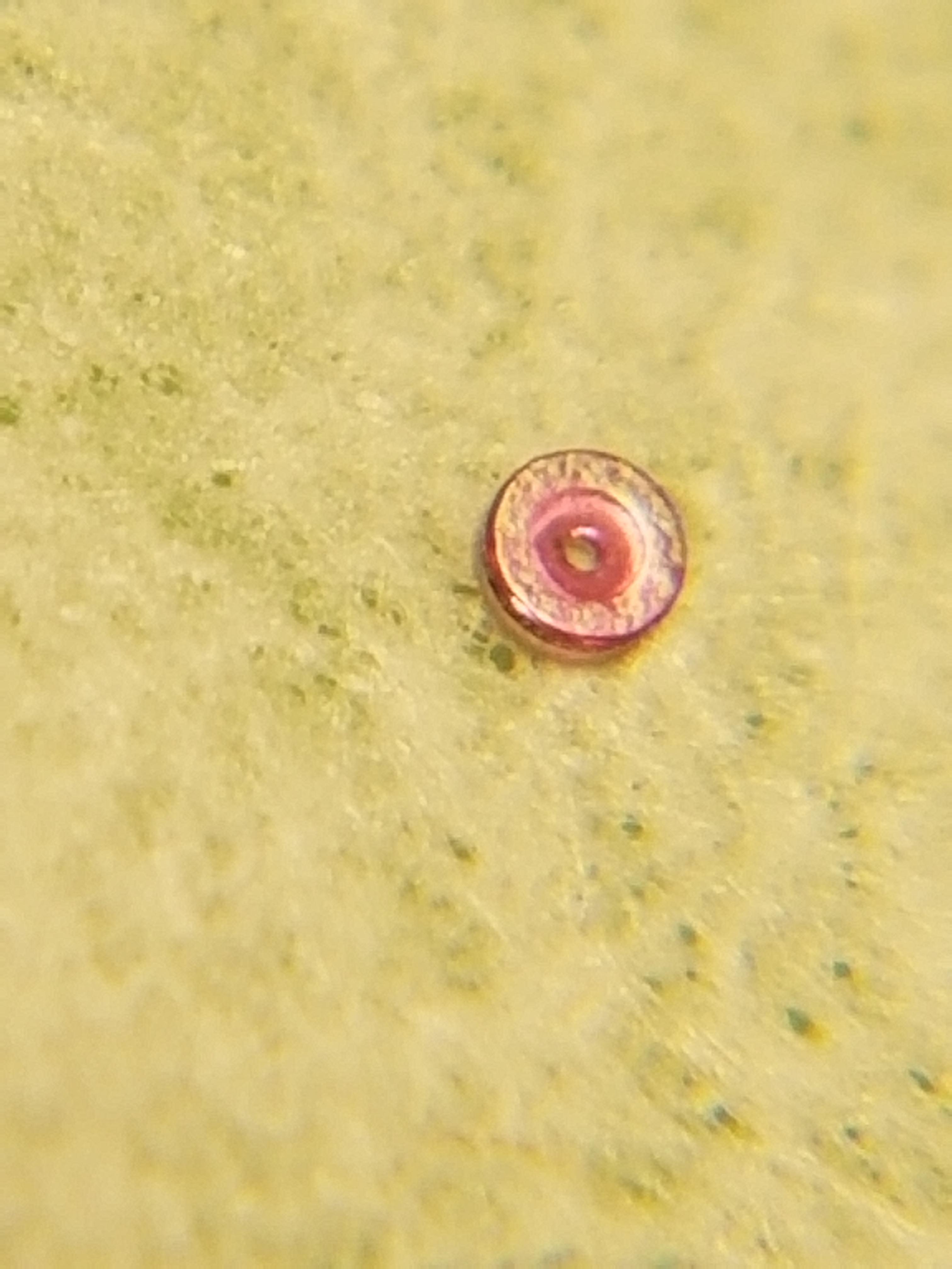

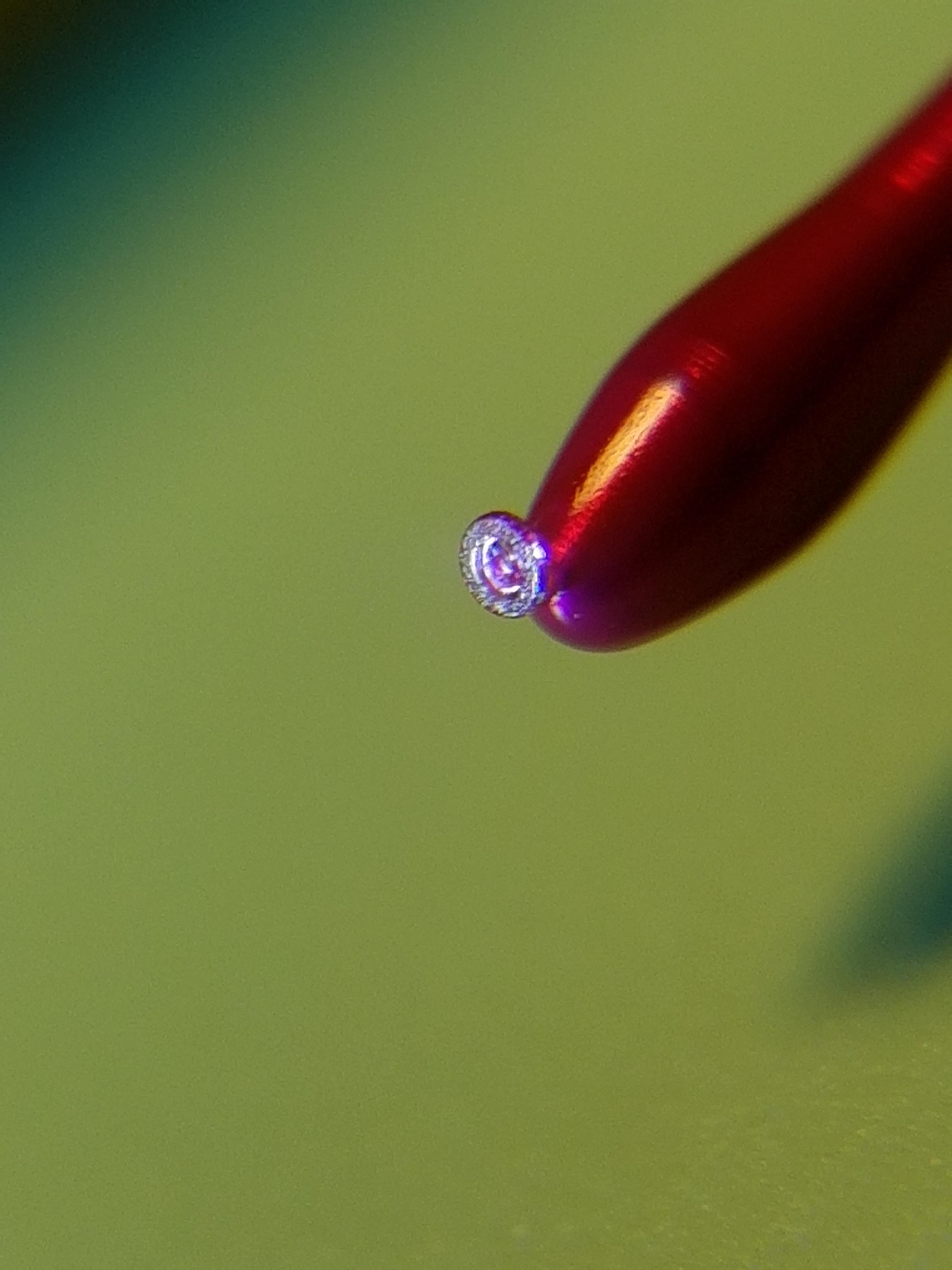

Rough and pitted jewel - What are the causes?
