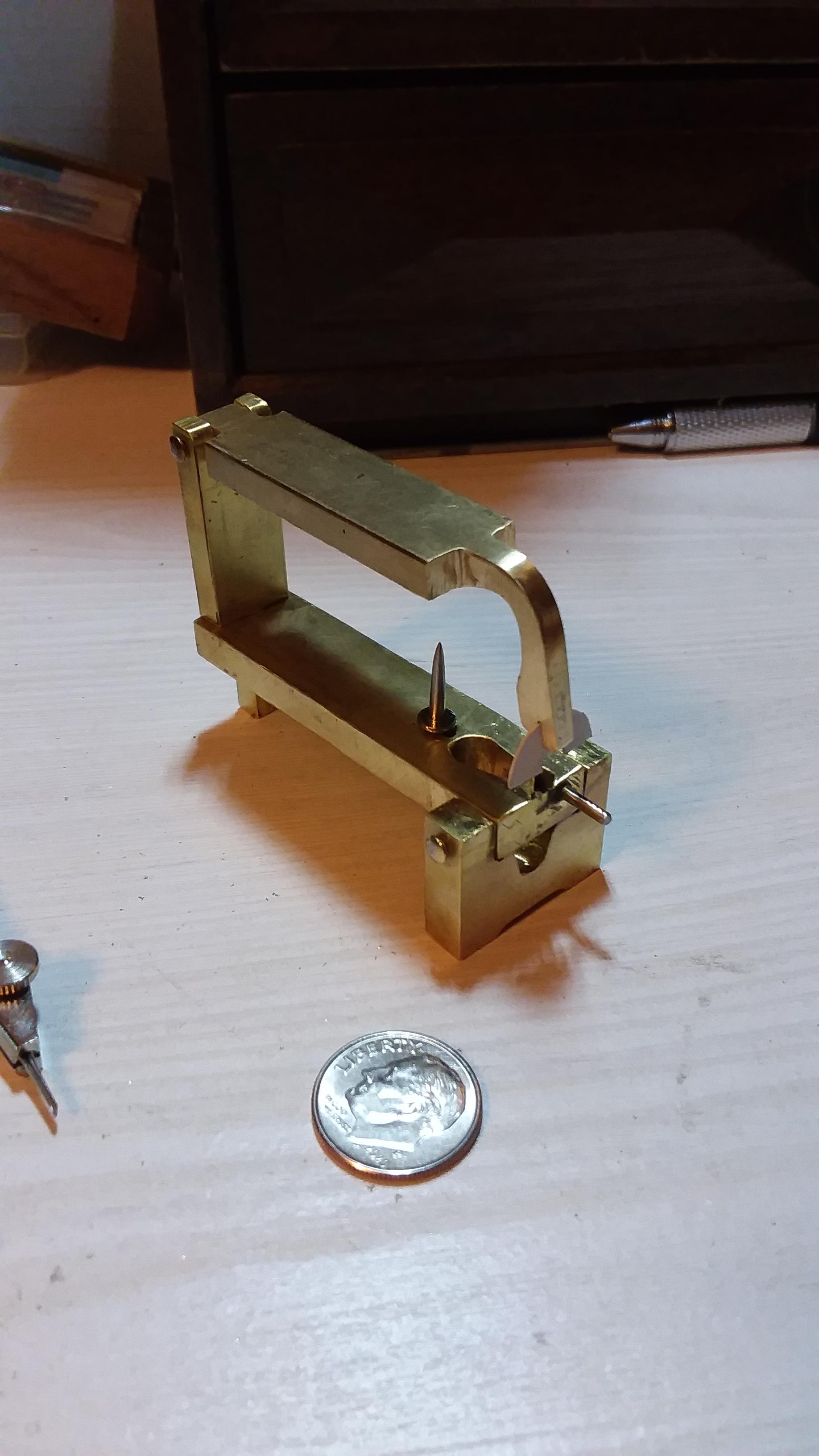

Made one of my own.  My remaining pieces of 1/4 inch brass were narrow so I had to adjust the measurements a tad.  But it functions very nicely.  I like that it supports the wheel at a predetermined distance and does not allow the hairspring to hyper-extend.  A nice tool in theory, and I plan to put it into practice and judge how often I use it and how it performs.  Thanks for all these replies to my query, folks.  You have given me the more thorough discussions I was seeking.

How did you bend the brass for the top lever?
First, I ground the underside part way in, to thin the arm just a little, right where I needed to bend it.
Then I clamped the long, thick end. I lined a pair of pliers with a strip of silicone from an old spatula, and applied light heat from a propane torch as I *very slowly* and gently bent it to the amount I needed.  I bent it against a wooden buck I'd cut for this.  When it got close, I then used a rawhide mallet.  I'd also drawn out a measured profile on an index card ahead of time.  I just bent a little, compared it to the card, bent a bit more, compared, etc.  I took my time.

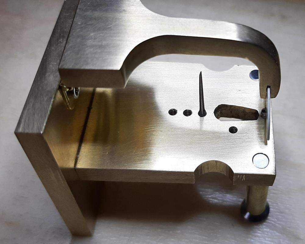

On 11/27/2020 at 8:47 AM, nickelsilver said:
If mine ever disappeared I would stop work until I had made a new one, it's that handy.
I've come to the same conclusion.
After breaking ANOTHER pivot whilst trying to hold a balance+cock to adjust a timing screw, I decided all watch fettling was on hold until I made one of these thingies. I've wanted one since this post started years ago, but wasn't sure I had the tools to make one.
I still don't have a workshop or any workshop power tools, but the good news is I managed to lash this one together with just the following :  Vice, hacksaw, files, cordless drill (🤣), M2 tap and die, M4 tap.  Oh, and a blowtorch for bending the brass.  So I bought some 5mm brass bar and started hacking.
Without workshop power tools I had to improvise the hinge  (I just bought a small brass hinge) and the front legs (just M4 screws).
I couldn't have done it without @nickelsilver's plan and pictures. Thanks
It's not perfect, but I just tried it on a balance to change a timing screw, and it works. It's great.  I recommend everyone should have one. So buy some brass and start hacking. I can provide guidance if anyone needs it (but my metal working skills are pretty limited).

You're going to enjoy using it. I've been using mine for just over 3 years now, and it makes working on balance screws so much easier. Between this platform tool and a balance screw holder, the work is barely a hardship.

To try and get vertical holes with a cordless drill, I bought one of these, (only £12 from ebay)
In the pic it looks all metal, but I didn't read the ad closely enough, as the one I got the red parts are plastic. Still, it does help make the holes vertical... ish.
The spike with the thread to hold the cock, is made from a nail - turned to shape in a drill with a file.
The white plastic is a guitar pick.
