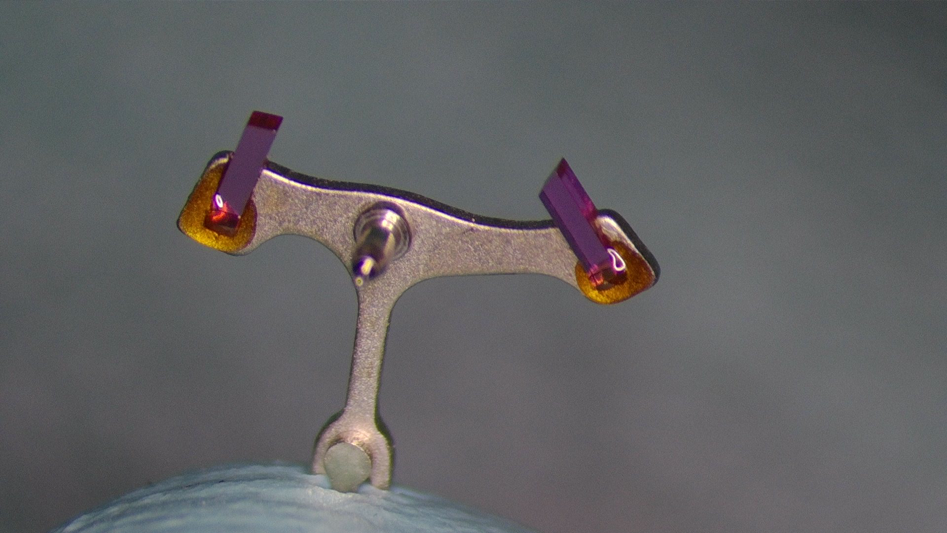

After circling around and around it, I finally adjusted the pallet-jewels of my 1975 Omega Speedmaster Mark II.
Inspired & guided by this article, and after having had a huge learning curve replacing "Garnet"-jewels for modern (too small, too low) jewels in a 120 years old pocket watch, I decided it was time to tackle the job.
There are many valuable tips in this article and all I like to do is to share a few of my experiences.
Like VWatchie, I also found that Acetone is a very effective way to remove the old shellac, more effective than industrial isopropanol. Acetone is widely available, no need to look further than your wife's nail-polish remover.
In my case the Acetone turned to old shellac in a white transparent substance, which later, while cleaning the fork-slot, caught me out. I simply didn't see it and hence the fork-slot wasn't cleaned properly.
As for applying the shellac; I tried the "pulling strands on peg-wood"-method and the "creating small balls"-method. To me, the "small balls"-method worked the best. If the size of the ball is too big, one can "nibble" it down with some fine tweezers.
As for the ease of adjusting the depth of the jewels, again I came to the same conclusion as VWatchie. For me it worked far better, and far more relaxed to adjust the jewels without the Shellac applied. As VWatchie said, hopefully there is enough friction between the jewel and the fork-slot to keep the jewel in place for testing. When Shellac is applied, one has to melt it, do the adjustment above a hot plate and there is time-pressure. Plus, without the Shellac, it became for me far more easy to see if the jewel had moved or not. Adjusting the jewels became for me far less cumbersome when done without Shellac.
As for melting the Shellac; initially I used a timer, to get an idea of how long it took for my alcohol burner / pallet-fork heater to get to the Shellac melting-temperature. That worked fine one day, not the other. The alcohol-burner I'm using is not producing a consistent heat and when heating 1 minute was fine on the day, it totally melted the Shellac to "water" on the next. The method I'm using now is to place the Shellac ball on the end of the fork-slot and heat the pallet heater above the flame, performing checks on very regular intervals. One sees the Shellac-balls slowly melting and continues until your are happy with the distribution. If the size of the Shellac ball is slightly too big, you stop before it flows out too far. If the ball is slightly too small, you just heat somewhat longer until it flows out far enough.
As for adjusting the jewels; one can use brass tweezers to push the jewels, from the rear, further out of the fork-slot, but I used peg-wood to push the jewels back in. I did some adjustment testing on junk pallet-forks and when using steel tweezers, the chances that you chip the impulse-plane or the back of the jewel, are very high. With steel-tweezers I had a 100% chip-score with the jewels of both test forks.

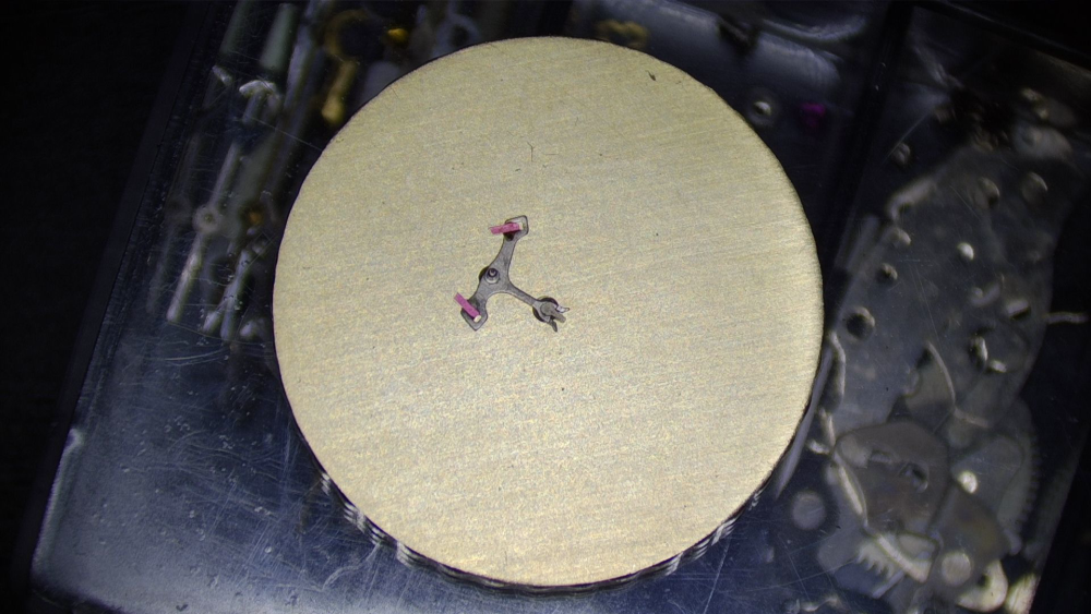

Ok guys I got myself a heating table and started experimenting with shellac and pallet jewels. I'm really a pallet noob. Here's an unedited video of the shellac melting. First the flakes melted into funny blobs when I had the table set to 100 degrees. I had to up the temp to 150 to get the shellac spreading more. How do you like it? Any comments appreciated. I also post some pics of the side profile.
That was a very interesting and useful video. Thank you for sharing! Interesting to see how the shellac contracts into a small bulge. That is, we don't have to be super precise about how we place it on the fork as long as it is in on the lower part as seen in your video.

I was originally planning to get one for drying parts but people pointed out that it can be used to melt shellac. That was my second try on the video. First time I put the flakes more like in the middle of the jewel hoping they would melt straight down but they ended up as little shellac balls too stubborn to melt any more despite turning up the heat. Putting the flakes further in the back seemed to help. The fork is on a small steel staking block. I should try some better heat conducting material like copper or aluminum.
Definitely try a different medium. I saw the video and thought "Six minutes!!!" All your energy is going into heating up that big steel staking block. A little sheet of brass with a hole drilled to accept the pallet arbor will make this much faster. The only thing with using a hot plate like this though is that you might need to come up with a solution where one side of the pallet is insulated from the heat. You won't always want to be melting the shellac on both stones at the same time. Old school pallet warmer tools often only conducted heat to one side, and you could turn the fork around to heat the other, or only one half of a split piece of brass would be held over a flame so the other stayed cool - the fork suspended across the 2 halves.
This is heavily on my mind because I am staying at my in-laws' house this week. All of their cookware is thick cast iron and it takes 15 minutes to bring a saucepan of water to boil.
Could be some capillary action taking place in the space behind the stone, the mass of the shellac is then held in that vicinity .
Some Euro coins are made of 89% copper and 5% aluminum, sounds like a good (and cheap) heat conductor. I've been watching those old pallet warmers on ebay.

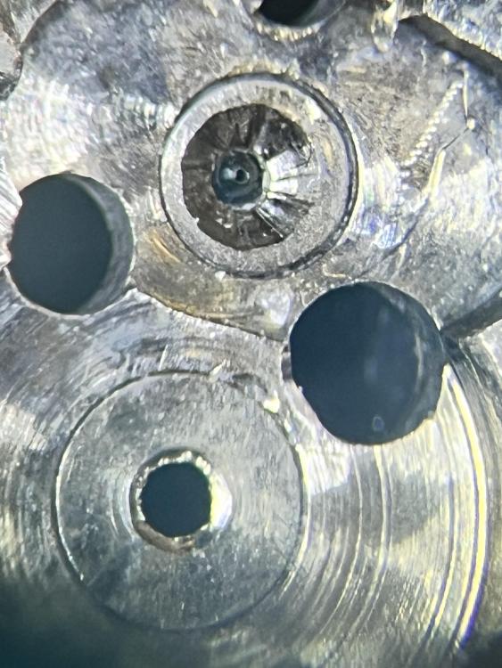

I'm glad to have found this thread. One of the issues with the c1920 Bulova I'm attempting to repair is missing shellac on one side of the pallet.
A question for those who are experienced with this: should I remove all the shellac from both sides, or will it be sufficient, if I can, to just clean one side up and apply new shellac to just that side? (I suspect the shellac is original to the watch so more than 100 years old.)
There's no hurry on this ... I first need to work out how I can replace a broken rubbed-in escape wheel jewel.
Hmm ... is the guard pin bent or is it just the angle of the photo? Add it to the list of issues for this watch.
If the shellac remaining is stable then there is no real need to remove that side of it, though one wonders why the other side is missing. Maybe not original, what is there looks a bit heavy and clumsy . The guard pin does look to bent, a picture from directly above will confirm it. This is the beginnings of understanding the escapement, adjusting pallet stone depth and how it affects the banking, guard pin and fork horn shakes. I can recommend a cheap good book if you can get it in OZ that deals with just the escapement, its old, over 100 years but all the principles still apply." Practical lessons on the lever escapement by TJ Wilkinson.  I think the rubbed in jewel is going to be harder to manage, needing some tool acquisitions.
