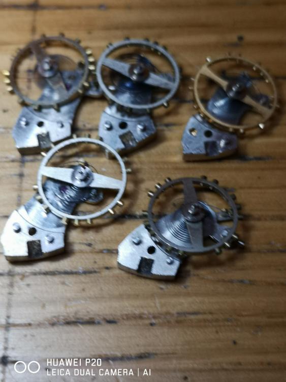

i am working on a nivada chrono (cal landeron 149). and the lower pivot on the balance staff was broke. I had about 4 other balances off other landerons mainly landeron 48s.
According to the work sheet parts are interchangeable so i tried a few and non of the locators on the balance cock lined up and fitted to the holes in the plate. There are little differences in them all ( see pic)
the landeron 149 seems to have different locator holes than the 48.
 SO that seems to say to me that there not interchangeable..
Can someone explain it to a newbie.
cheers
gary
