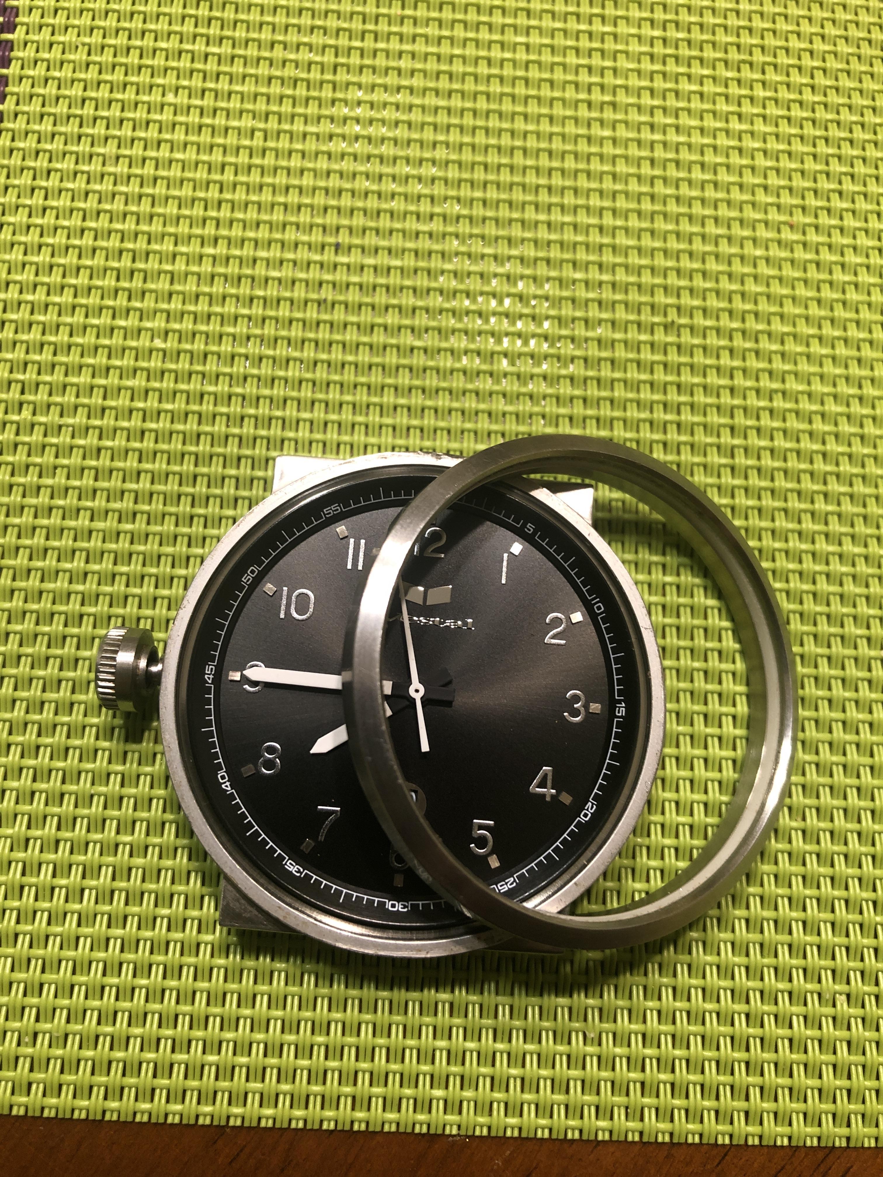

Hey everyone.  I just joined up after trying to track down info regarding glass replacement.
 I threw my watch in my nightstand and a few days later I dug it out and found that the face had a huge crack across it.  Don’t know how it went down but I’m definitely interested in fixing it.  It’s a Vestal Observer.  Yea you may say it’s a cheapo but I like the way it looks and it’s a great challenge.
I look forward to learning a bunch and fixing my watch

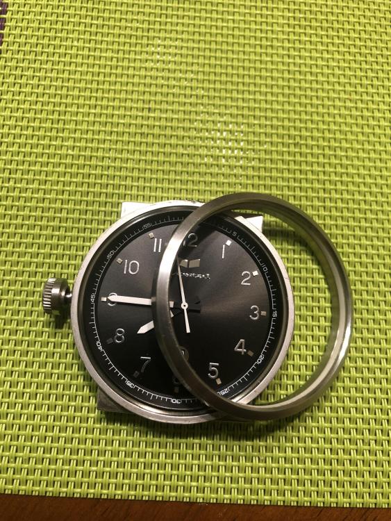

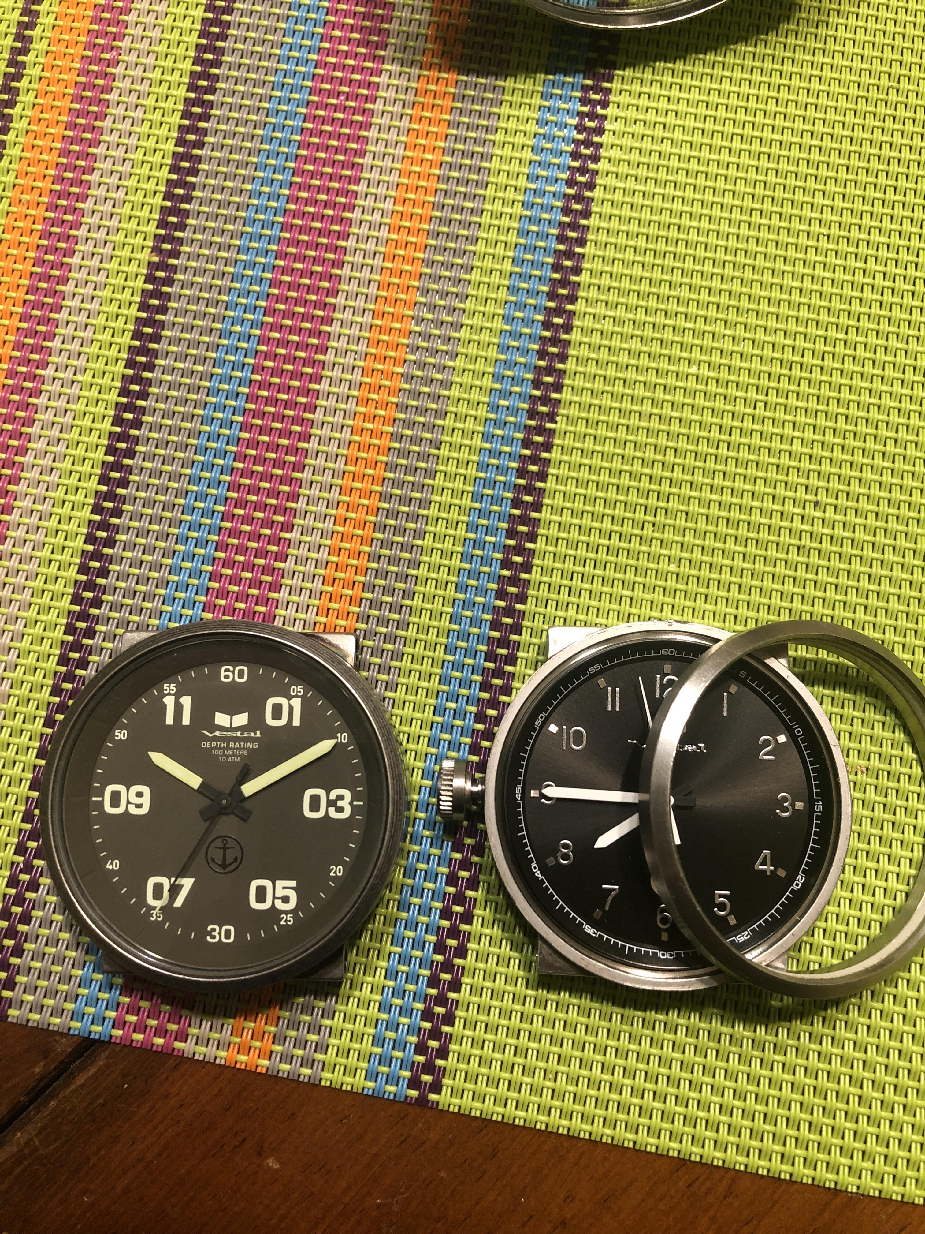

The first is the damaged watch with the glass pressed out. The second photo is both , the one on the left being a donor watch
Donor for parts, or you are thinking about swapping the crystal?
I was confused by your " I threw my watch in my nightstand and a few days later I dug it out and found that the face had a huge crack across it." Did you mean Crystal  or Glass, as i do not see any cracks on the dial. That's why i asked to provide photo.
If it's just about installing a new Glass, it is very simple if you've got the right glass and basic tools. HectorLooi already suggested visiting Esslinger's website. The basic concept is:
- look at your old broken glass to determine if it was Mineral Glass or Acrylic (plastic). In your case it is Glass
- using a caliper, measure Outside Diameter and Thickness of the old Glass (put broken pieces together) and also measure Bezel's Internal Diameter
- Note if the old glass was glued or pressed in (was there a PTFE i-shaped or L-shaped gasket around the old glass?)
That info should be enough to order your new Glass with i-gasket and you will need a Press with Dies.
You better watch lots of videos on youtube also to avoid ordering wrong parts or cracking your new glass. This type of glass is so cheap that you may want to order 2 - just in case :-).
