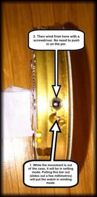

The crown pulls up to set the hands to alter the time, and to wind it you push the crown down and turn. It's when you push the crown down to wind it slips. I took the movement out of the case and looking where the winder shaft fits,,there's like a little piece at the bottom. If I insert the winder shaft or a small screwdriver this pushes down,,which I imagine engages the winding mechanism when you turn it?
I also took the mechanism out of the case,,that looks ok?
post-760-0-08157100-1426955019_thumb.jpgpost-760-0-14510900-1426955036_thumb.jpgpost-760-0-96333700-1426955066_thumb.jpgpost-760-0-35466100-1426955081_thumb.jpg
Hope the photos are ok.
The stem and sleeve look to be in good condition. The depth of the sleeve does have to be set correctly so that setting and winding functions engage and disengage correctly. If the winder is slipping the I'd try 'tightening' the sleeve a bit.
That said, how do you know the mainspring is broken? Does the watch wind and wind forever? Do you feel a bit of resistance when winding then it slips?
Try winding it outside the case. See photo.
That said, how do you know the mainspring is broken? (A) Does the watch wind and wind forever? (B) Do you feel a bit of resistance when winding then it slips?
The answer in both cases with a manual wind watch is yes, and with a watch like yours it would be a good idea to confirm your suspicions by winding it out of the case.

Just tried lifting the little lever up and winding,,,,it goes a couple of turns then it slips, you can feel a slight "clunk", when it does.
I did take it into a watch repairer, that's who said the main spring was gone and the winder shaft was worn. He could get a mainspring but not a winder shaft/sleeve. So, more or less scrap.

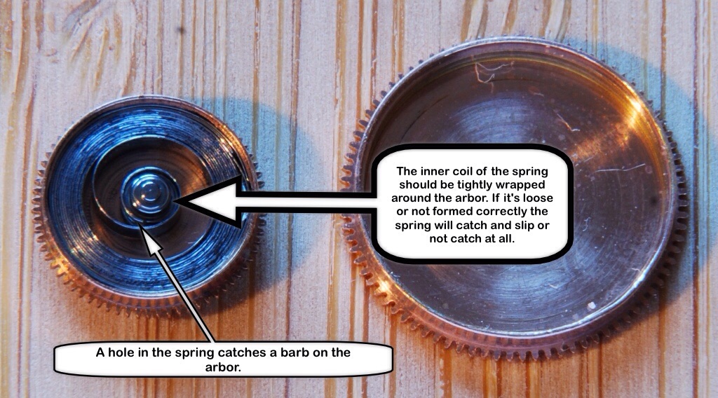

The mainspring is an inexpensive repair. Springs are readily available. It's also possible that the spring is not broken but one end is slipping off the barrel arbor or the hook on the barrel itself. Have to open the barrel to check.

That description clears it up. My best guess is there are two separate problems that need to be addressed. And both may be very easy fixes.
1. The main spring barrel needs to be opened and you need to see if the spring is broken or if it's not catching the center arbor. Sometimes when they slip a few times the force of the spring slipping opens the inner coil of the spring even further which makes the slipping worse...until it won't catch at all. This can be repair by gently closing the inner coil with some pliers so that its tighter around the arbor.
2. If the stem isn't "clicking" firmly in place that will cause all sorts of problems when winding. These fingers can often be bent slightly inwards so they engage the stem more tightly. Pull the stem out of the sleeve by pulling on the square end. Squeeze the fingers slightly inward. Reinsert the stem and see if it "clicks"

I wanted to open up the main spring barrel to see the spring,,but it won't come apart!
The arbor came out, but the 2 halves of the casing won't seperate. They will come apart very slightly,,but it looks like the spring is joined to the flat,toothed half of the casing.
I don't want to try to pry it apart in case I damage it.
Is there a way to open this up?
Never seen a barrel like that. Usually the arbor won't come out until the cover is taken off the barrel.
What does the arbor look like?
Can you tell if the spring unwinds against the silver portion of the barrel?
Or is the silver portion a cover that slides over a brass "wall" that the spring unwinds against?
Got the barrel apart, with a bit of careful prying and twisting.
In the wall of the barrel there's a notch for the spring to catch on, while on the brass lid part the centre comes down with a notch for the spring to catch on that part.
There's nothing on the arbor for the spring to catch on,,that gets pushed thru from the outside.
If you wind the spring into the barrel,,how would you get the middle to catch onto the notch in the brass lid part?
You'd wind the spring into the barrel then manipulate the brass cover onto the barrel so that the inner coil of the spring is around the part with the notch.
Then rotate the brass cover until the notch engages the hole in the spring.
