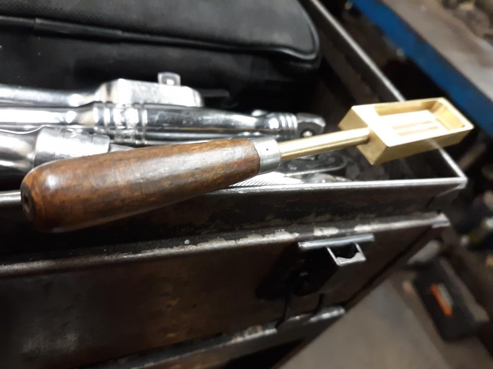

Flame bluing tray for hands, screws
By luiazazrambo · Posted
