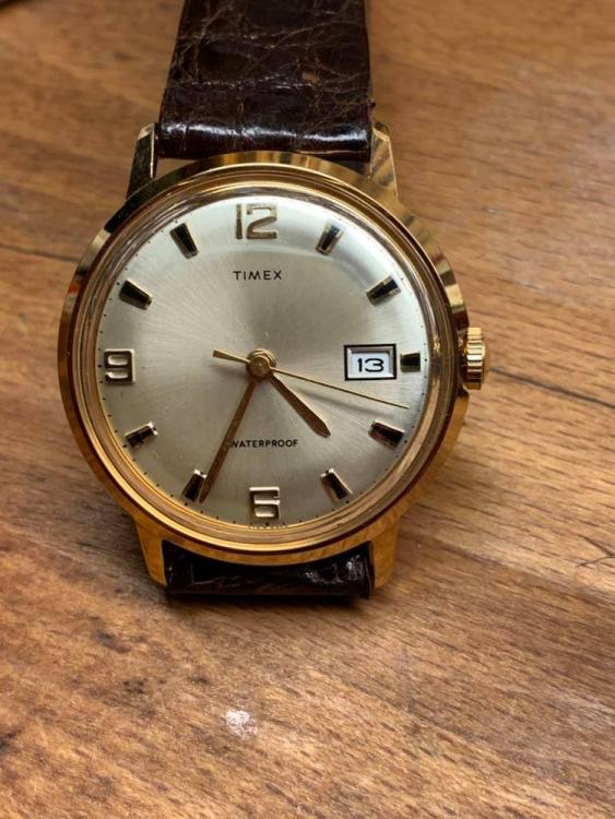

Finally gathered the courage to try a Timex!
I found this automatic dirt cheap (pic’s attached) but with a nice dial so why not give it a go.
Found that the h/s spring was quite bent, probably due to someone being careless with the timing setting. Got that sorted decently without any disassembly and now the wheel spins freely and h/s looks ok.
but it doesn’t start up and when turning the crown I hear a distinct click after a few turns that makes me think there’s something wrong with the main spring. Are these movements equipped with a similar slipping m/s as regular automatics? The sound I hear makes me think more along the lines of a broken spring in a manual.
I understand we have some devoted Timex guys on the forum and would appreciate any hints on how to proceed.

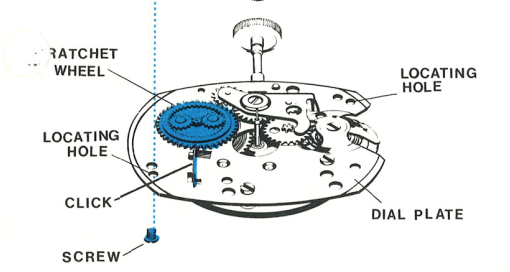

I recovered sufficiently to do a teardown and cleaning of my Timex. It is a M109 movement. I discovered the reason for the loss of power in this watch. The teeth of the winding ratchet assembly are worn off to the point that it slips when the spring is wound to a certain tension.
I will remove the winding ratchet tomorrow and examine it under my microscope to see if I can do anything to the worn teeth. I wonder if there are any NOS replacement for this part.
Are you sure this is the cause?
I think if it looses power it is more likely to be the click spring. If this is badly worn, it will release or slip when the power in the mainspring increases.
Does it manually wind without slipping? If not, the click is worn.
Silly old me put the winding ratchet upside down. I checked it with my 12x loupe and the teeth look worn but still acceptable (like the choppers of many of my older patients).
I flipped it around and it seems ok now. I didn't take note of the orientation of the wheel when removing it. But when I examined it, I noted that one side had a groove where the rim of the brass washer sits, so I assumed that it must have been caused by wear. So it placed that side facing up. But now when I think about it, it can't be caused by wear because there is no movement between the wheel and the washer. I wonder why Timex put the groove there!
