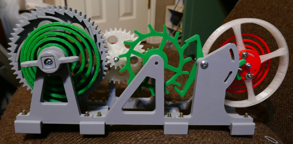

It is one of the most utilitarian tools I have other than a screwdriver.  I have repaired many things around the house by printing replacement parts.  I have also created many tools and add-ons to other tools.  There is a huge repository of designs that others have done on the internet.  I love to make my own stuff--do the 3D design but when I find someone has made what I need, I download and print!!  Below I show a picture of a 3D printed fully functional escapement that built three or so years ago.  It is a wonderful demonstration of how the escapement works.
