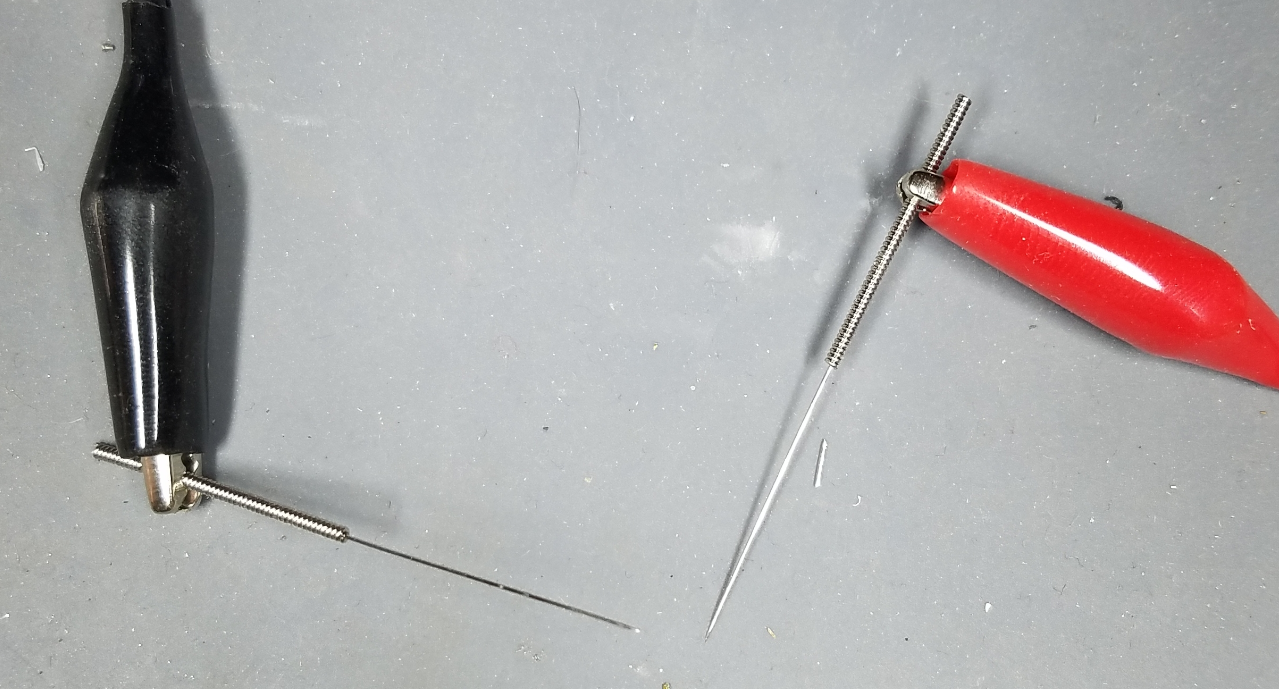

4) A digital multimeter is useful in general.  However, the leads that ship with virtually every multimeter on the market are unwieldy at the fine geometries of watches.  My solution for this is to purchase some accupuncture needles on Ebay and using alligator-clip leads, grab the needles and use them as probes.  Still tricky...you have to focus on the probes and then look up at the meter.

I will make it easy for you.  Here is a good meter that will meet your needs.  I have a different branded version of this meter:
Aneng Multimeter
For my work that must be traceable, I use high-dollar Fluke meters, but they are way beyond what you need here.
I would not use this multimeter for high voltage mains testing even though advertised to do so.  My EE buddies on the forum are not too excited about the way these are built for best safety...just FYI.

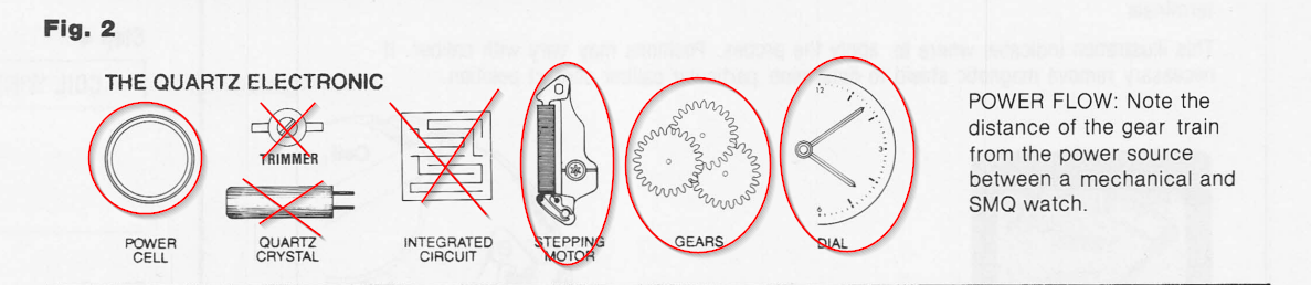

Re Tuning Fork watches: I have never worked on one.  However, my father was trained to work on them--I have his certificate of training above the watch bench where I work.  I have lots of Accutron coil assemblies that he labeled as "bad."  I frankly do not know if they are bad and I wonder if he knew.  He did not use any exotic equipment to test and repair Accutrons other than a Bulova monocular microscope.  He used a Radio Shack analog volt-ohm meter and only used it for checking batteries (it is good for that).
So I refer to the diagram in the SMQ service manual which I have attached with annotations.  Those items encircled CAN be repaired.  The X-marked items cannot (maybe the crystal for the fearless).  So the only testing that needs to be done is that which points you to those items that can be repaired (as I alluded to in an earlier post).
Back to the Accutron modules.  There is a transistor, resistor and a capacitor as I recall.  All three of those can be replaced if you have a fine soldering iron and sufficient skill.  The equipment to test the transistor is, at worst, a curve tracer ($$$), and at best, a multimeter that has a transistor tester built in (cheap).  But to test it you would need to remove it and extend the leads to fit in the transistor test socket (there are other ways...but).  Can you find the transistor to replace a bad one???  I really do not know.  I doubt it is a conventionally marked 2Nxxxx device.  Resistors and capacitors are trivial to find.
Measuring current to troubleshoot the gear train is a good idea, but why not do it the same way you do for mechanical watches?
