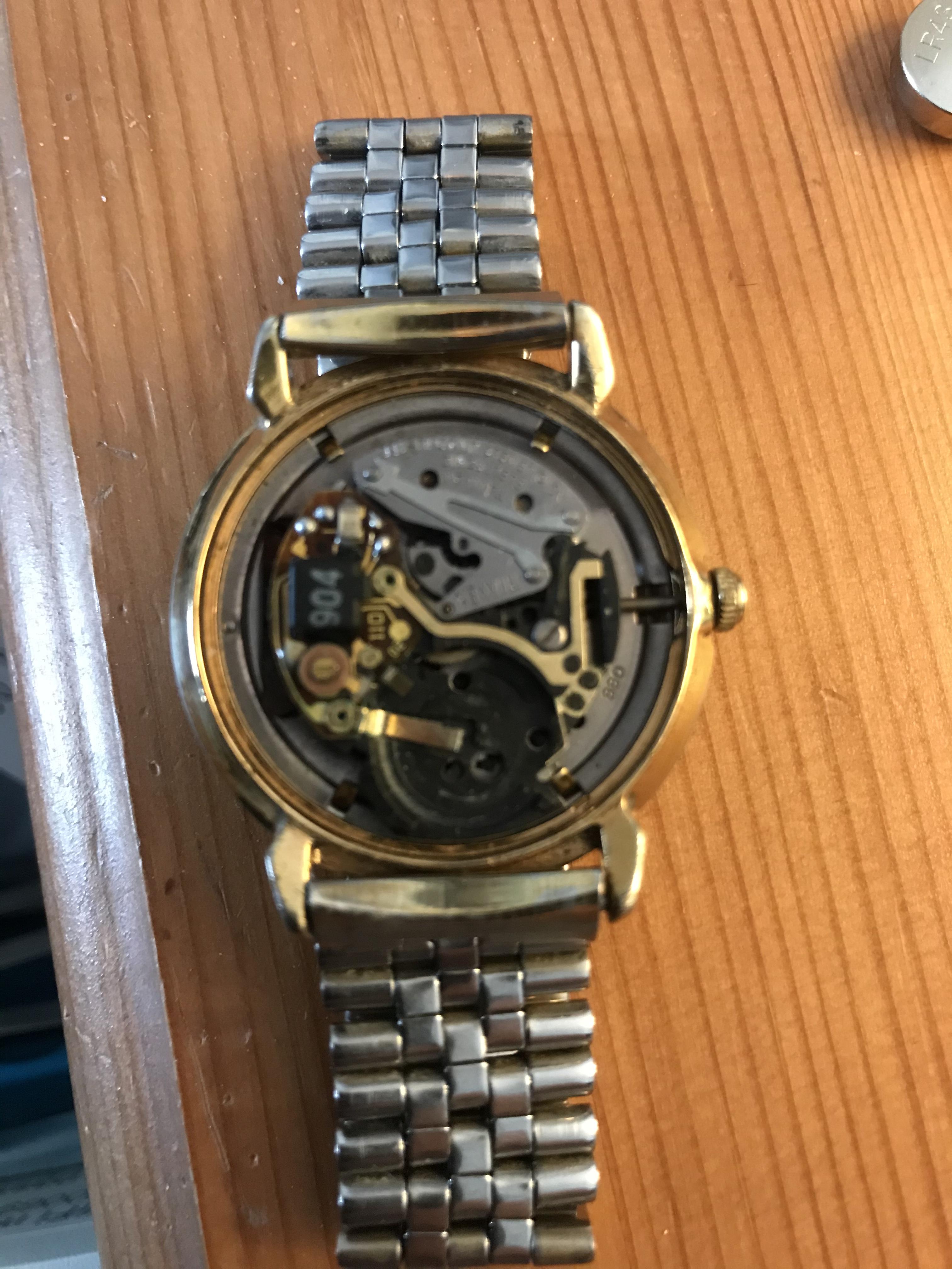

I have one of these “jumping” minute hand timex’s which I believe is an M56. It started to work when I put a new battery in it and it clicks every minute, however the minute hand jumps approx 2 mins!! Anybody else had this problem or does anyone have any idea what’s causing it?
As I said check the minute hand is not loose.
If that's OK then check the magnet in the movement only flicks once per minute and does not bounce twice.
If twice then a spring may be broken or pulled off.
