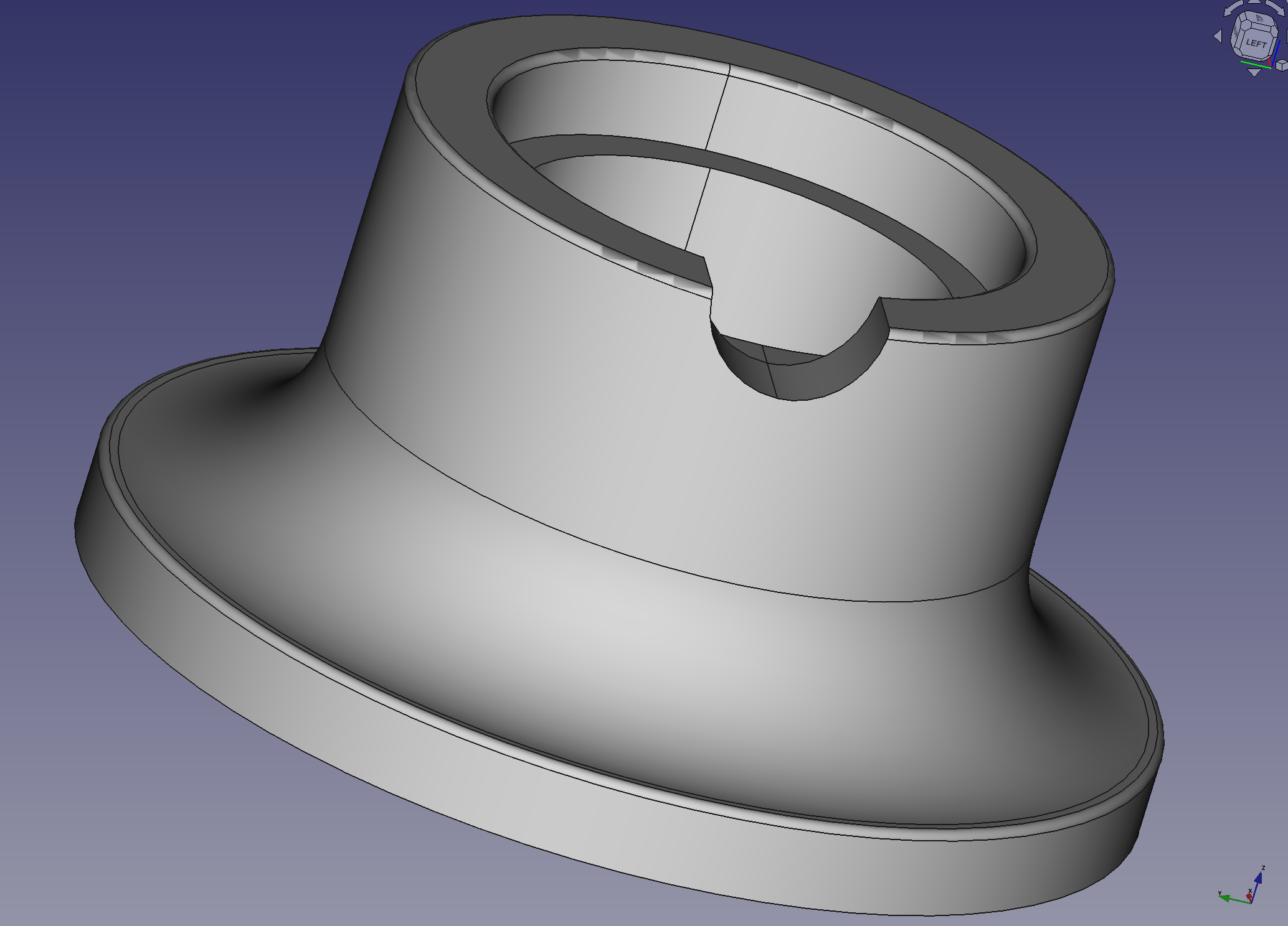

Movement holder made with 3D printer
I like the well-known brass movement holder for doing work, but when I have a movement in the "waiting for parts" mode, it is nice to have it sitting in a nice stable holder.  So, I decided to print this movement holder.
Print time was 20 minutes.  Probably took me about that long to design it.  Now that I have one complete, I can tweak it for other movement sizes with only a few minutes of effort.
FYI, this is a Landeron 51 chrono.  I cleaned it and it is running fine, but I need hands and a decision about the dial.  I have a dial, but it is in really poor shape.  I see hands and dials on Ebay, so I just have to decide which one to commit.

This type of holder should be so sligly undersized so to grab thanks to a slit in the diameter. And when is for a chrono mov.t all the difference is made by having pushers.

On 8/14/2021 at 2:35 PM, LittleWatchShop said:
Here is an update on the movement holder.  When I store an unfinished movement in the popular domed parts carrier, it tends to flop around if I try to place it in the center.  The solution was to put a base on the holder that sits nicely in the center partition.
I have a 3D printer on the way and am playing around learning FreeCAD. This looks similar to what I will be trying for my first project (movement holder that fits in the hand setting tool). Could you post the FreeCAD file? I'd like to see if I can adapt it to what I am trying to do.
By the way, your movement holder has that 'ledge' that is below the top of the holder which the movement rests on when in the holder. When you designed how thick the ledge is and how far down from the top it is, did you get those numbers from measurements you did on the movement or is there some other way you decided on those numbers?
WRT does not support FreeCAD file types.  PM me and I will attach to my reponse (if it lets me), or we will go offline via email.
My design was a simple hack more or less.  All measurements except for the width of the movement were SWAGs.  You will see in the FC file, I created a spreadsheet to parameterize the elements.  The extra piece on the bottom to fit the movement holder was also an "addon" hack using the Part workbench.  It too is a hack...lol.  When exporting to stl, you have to select two sets of elements.  If I were to do it over again, I would assemble the whole thing using Part Design workbench.

Wow, great minds think alike, I use freeCAD and also have a 3D printer being delivered by Santa 🎅, I currently have to bribe my son to use his. I was was thinking on Friday afternoon that it may be cool to try some parametric modelling in freeCAD and sketched out a parametric movement holder. My idea was to measure the movement outer diameter and then let freeCAD spit out the complete design.
Here is what I sketched in my lunch hour (including a doodle I did whilst on a very boring conference call) on Friday:
I also plan to put a fillet (0.25?) on some of the outer 'corners' mainly for aesthetics, and one on the entry to the seat to make it easier to get the movement in, but didn't get time to add them to my sketch, blue circles above.
Also l1  is the cutout for the stem/crown, was thinking of making it U shaped rather than square, but would model it as a square and simply fillet the corners to make it a U shape.
Just in case you can't make out my handwriting:
d1 = variable (the movement holder OD and the only input you need to make)
d2 = d1 + 10 mm
d3 = d1 - 5 mm
d4 = d2 x 1.5
r1 = h2
l1 = 10mm (with 2mm filets{?} to make it a U shape)
h1 = 5mm
h2 = 30mm
h3 = 5mm (will only need this outer dimension also to be h3 if I decide to keep the 'shoulders' at the top of the model, thinking I may just skip the outer shoulders and have the top and bottom linked by an ark without the shoulders... I will need to think about this....any ideas??? My initial thinking is that the shoulders may flex a little as you push the movement in and grip the movement better, but not sure how realistic this idea is?) - see version 1 and version 2 below.
Once I get to grips with it, I'll post the freeCAD design on thingiverse and you can also PM me for it from here 🙂

Think I did it.....
Below  is my parametric movement holder (size 30mm movement)
Below is size 10 mm movement (minimum size before model breaks):
Below is size 70 mm movement (maximum size before model breaks):
And here is the Parameters table - only need to change the red text cell at the top:
PM me if you want the link to download 🙂
This is in FreeCAD not sure if it will play nice if exporting in other formats, but I'll give it a go if you let me know what you need.
