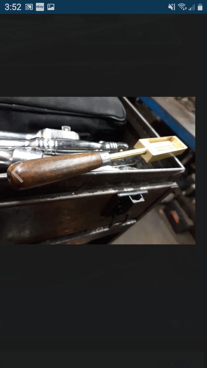

I get you now. Put the hand in the middle of the tray and go with the flame in circles around the sides avoiding the centre, get the heat to work its way from the sides rather than going lengthways heating it up.

Bingo! I couldn't have said it better myself!😊
Since you're doing some bluing, I had posted a chip tray I made back in January. Works pretty good. Weasol had a good idea to use a clock mainspring barrel and OH had a good idea to use an old penny, which I'm going to try sometime.
