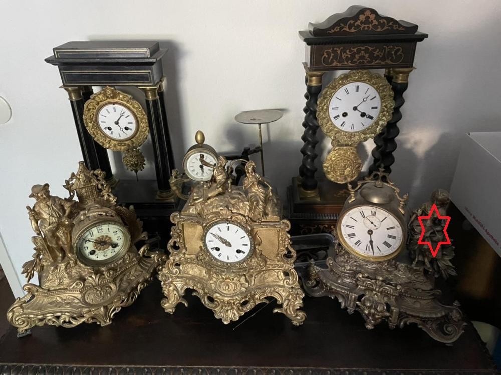

When and where will the sale be. I could spend days looking at all that lot. Just looking at those few photos this is the star of the show. It's a French alarm in a nice case you don't see them in that type of case they are normally just in a round drum case that is why they are known as a French drum clock.

You could ask him about the one I like. I would if possible to see the movement. The two French portico clocks as well, there the two that are standing behind the one I like. Again I'd like to see the movements. I know what they are like but still need a look.

Feast your eyes on these, they belonged to my friends later farther.  Not great photos and no movements yet. They will all be for sale sometime in the future
Rich. What a fantastic collection, his father must have been very passionate about it. Shame I'm Not into clocks at the moment.
