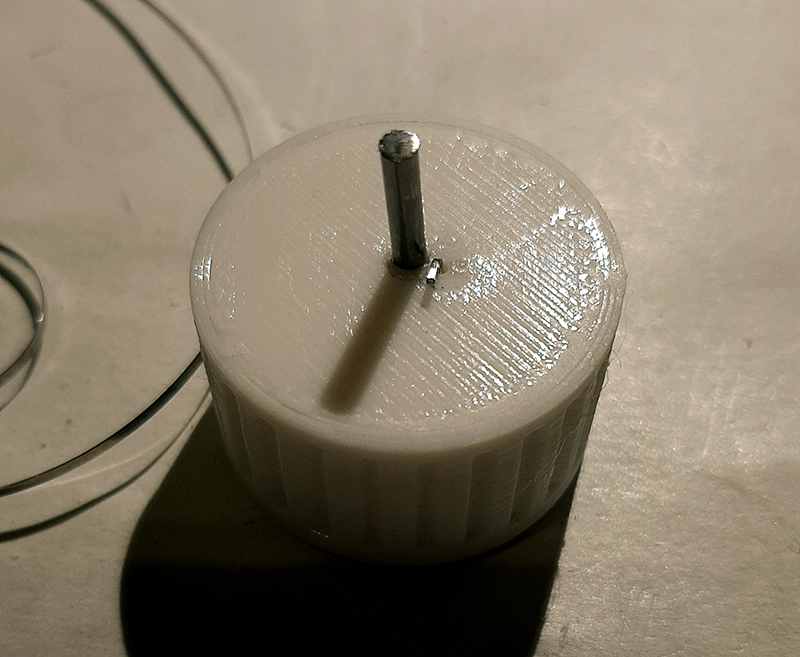

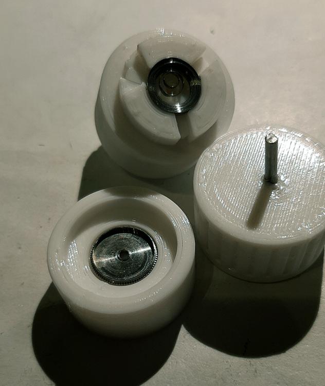

Hi there Zero!
After a lot of problems with the courrier I got the first set of pieces to play with, I was very excited, but the joy lasted only two tries 😪
I've tried to cut the stapler to the best of my understanding. Then I made a first try and although the spring seemed to slip sometimes inside the housing, I managed to get all of it into the tool, even the bridle that was a bit tougher. However, when trying to take the winderbase off, the spring wanted to come with it instead of staying in the housing, so it didn't work this forst time.
I thought that maybe the problem was that the stapler was a bit too long, so I cut it a bit smaller. I tried to load the spring again into the housing, this time I could not get the bridle into it. When I took the base off, I saw that the rod had broken. I probably did something wrong. Any advise you can share is very welcome.
EDIT: Forgot to mention that when I received the pieces, the rod on the base couldn't get into the hole of the plunger. I sanded it in the middle (not in the zone that is now broken) until it could get inside the hole with no apparent friction, but maybe I should have sanded it a bit more (or a bit less, who knows) Next time I think I will try to look for a way to broaden the hole instead.
Unfortunately I only ordered one winder base, so I will need to order it again, and that will take some time.
Anyway, thank you very much for sharing this design, I'm sure I'll get it working soon!
Edited by aac58
Alright, today I've done a bit of brico. After sanding the remains of the winder base arbour, I've replaced the broken arbour using a pin vise and a 2 mm drill bit and a 2 mm metal rod.
I tried again with a bad shaped Seiko 70xx spring I'm using for testing. For me it's really difficult to insert the staple into the spring hole. Or more specifically, I cannot, as there's no room for the staple between the arbour and the spring, and I think I deformed the spring even more. However, after trying afew times, I managed to close the base with the barrel housing/plunger set. The staple wasn't into the hole, but it was making enough friction to wind the spring into the housing.
This time, to take the base off of the housing I used my tweezers to prevent the spring to come off too, mostly the same way I've seen others doing with the real winders.
Tranferring the spring to the watch barrel was a bit of try and pray. I recon that the barrel bowl is a bit too big for the barrel. I used the 11.8 barrel bowl, but in the printed thing I measure about 12.2 mm. I guess the 3D printers (or the printer used by the printing service I used) are not accurate enough, so I should have ordered a wider set of housings.
Nevertheless, the second attempt was successful (in the first the spring didn't get into the barrel).
I have to practice some more, and order more barrel housings, plungers and barrel bowls sizes, but if I get the hang of it it's going to be a great tool.
I like the metal arbour, I think I'll print a base with a 2mm hole instead of the original arbour. Maybe I should look for a thinner metal rod to allow for more room between it and the spring, so the staple can get into the spring hole.
Edited by aac58
Hi @aac58, nice work with the metal rod fix!
When you finish unwinding, you should unwind just a little bit more and the staple will just unlatch itself and just come off. I think I forgot to mention this part in the video.
Most likely the winding stress has destroyed it, looks like your print service provider's plastic material may not be too good, unfortunately. Personally I did not have this issue even on bigger springs, I only broke it when I dropped them 😅 Maybe other members here can comment on using stronger materials.
Thanks for mentioning this. I also seem to have this problem with the plunger (sometimes). I will add a little bit more fit clearance to solve this problem, in the next release.
Actually for smaller springs, this seems to work for me as well. However, I think it is best to get the staple into the hole. What I do is just use an Arkansas stone to file the staple until it gets small enough to enter the hole (if your staple is too big).
I like this idea very much. Please share with us the metal arbour material you used. It looks like a nail? I was thinking maybe use springbars 😂
I can design a separate winder base with an arbor hole with hook holes that are side by side (close to each other) based on your suggestions.
I bought it in a hobby shop. The tag says "2 mm x 1 m steel rod". BTW it was very hard to cut.
