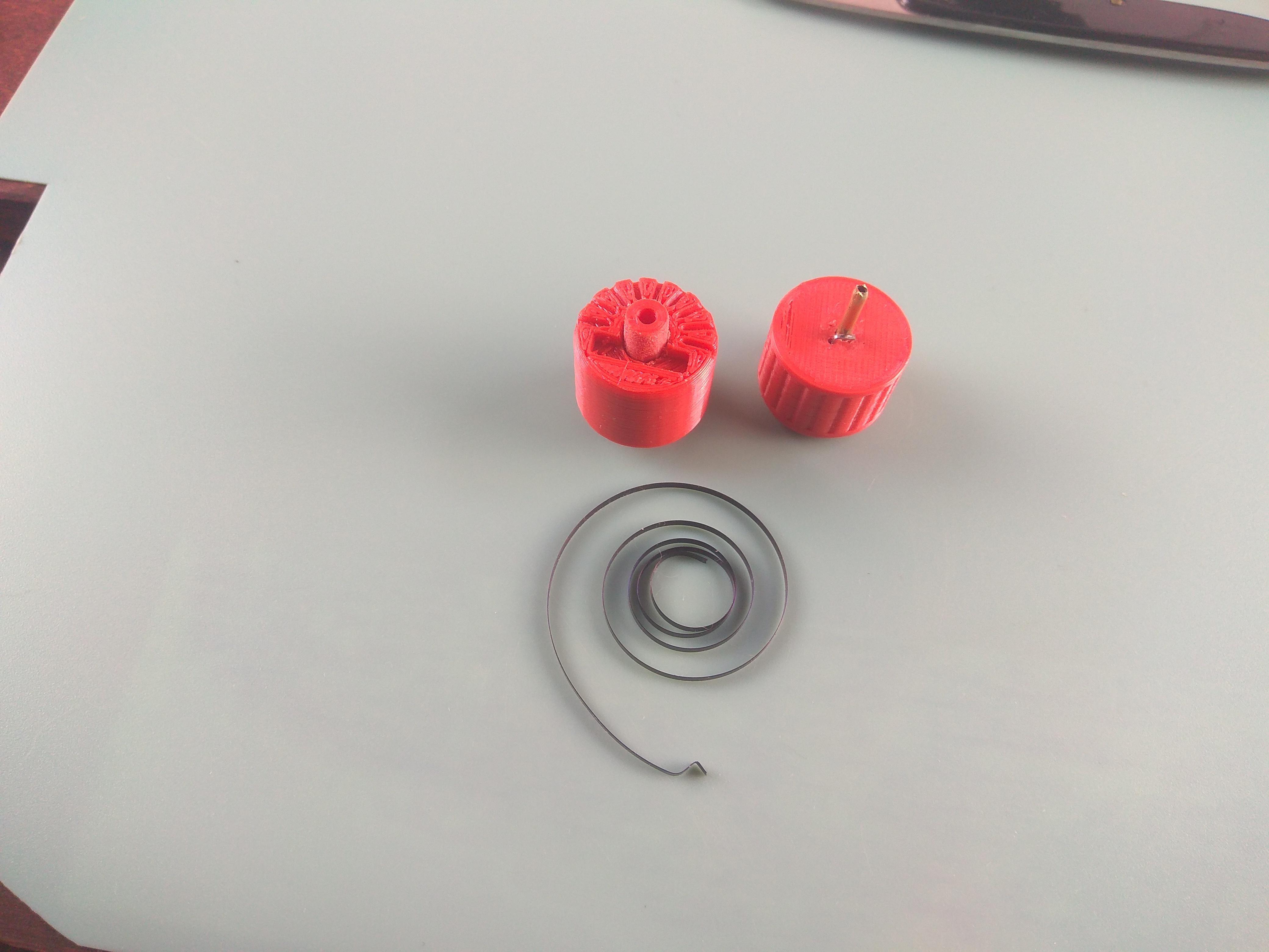

I printed up a couple of winders (9.0 and 10.0), but have yet to test.  When fitting up the winder base to the plungers, there seems to be more slop than I expected between the dowel and hole in the plunger.
I printed these with 0.12 layer height but the text didn't come out too well.  Had you considered eliminating the "M"?  Then you would have some extra space to increase the font size.
I first tried with a manual mainspring and the 9.0 mm winder.  Got it wound into the winder.  When I pulled off the winder base, the staple was bent up some.  I was able to load the mainspring into the barrel successfully.  That go me rather excited.
I next tried with an automatic mainspring and the 10.0 mm winder.  Got it wound into the winder.  When I pulled off the winder base, the two ends were sticking a bit out into one of the pusher slots.  So, I had to remove it from the winder and try again.  Got to the point of getting the bridle into the winder and the eye end of the mainspring broke off.  The staple was quite mangled.  So, I need to source a new mainspring.  Not sure if I was doing something wrong or not.
Now, if there was a way to use the barrel arbor itself to wind the spring into the winder base, then that would seem better than using staples.
Hi. Some points that may be of help:
  1. How did you latch the arbour hook to the mainspring? Please refer to the wiki for diagrams: Attaching-the-Arbour-Hook-to-the-Mainspring.
    If you used incorrect styles when latching, the hook will get mangled and the spring may deform.
  2. From your pictures, its seems like you are working on a vintage mainspring. The old types are made from a different material from modern mainsprings, and get "tired" or "set". They may deform/break no matter what you do, due to age. Please refer to the wiki: Selecting-the-correct-winder-size-for-your-mainspring
