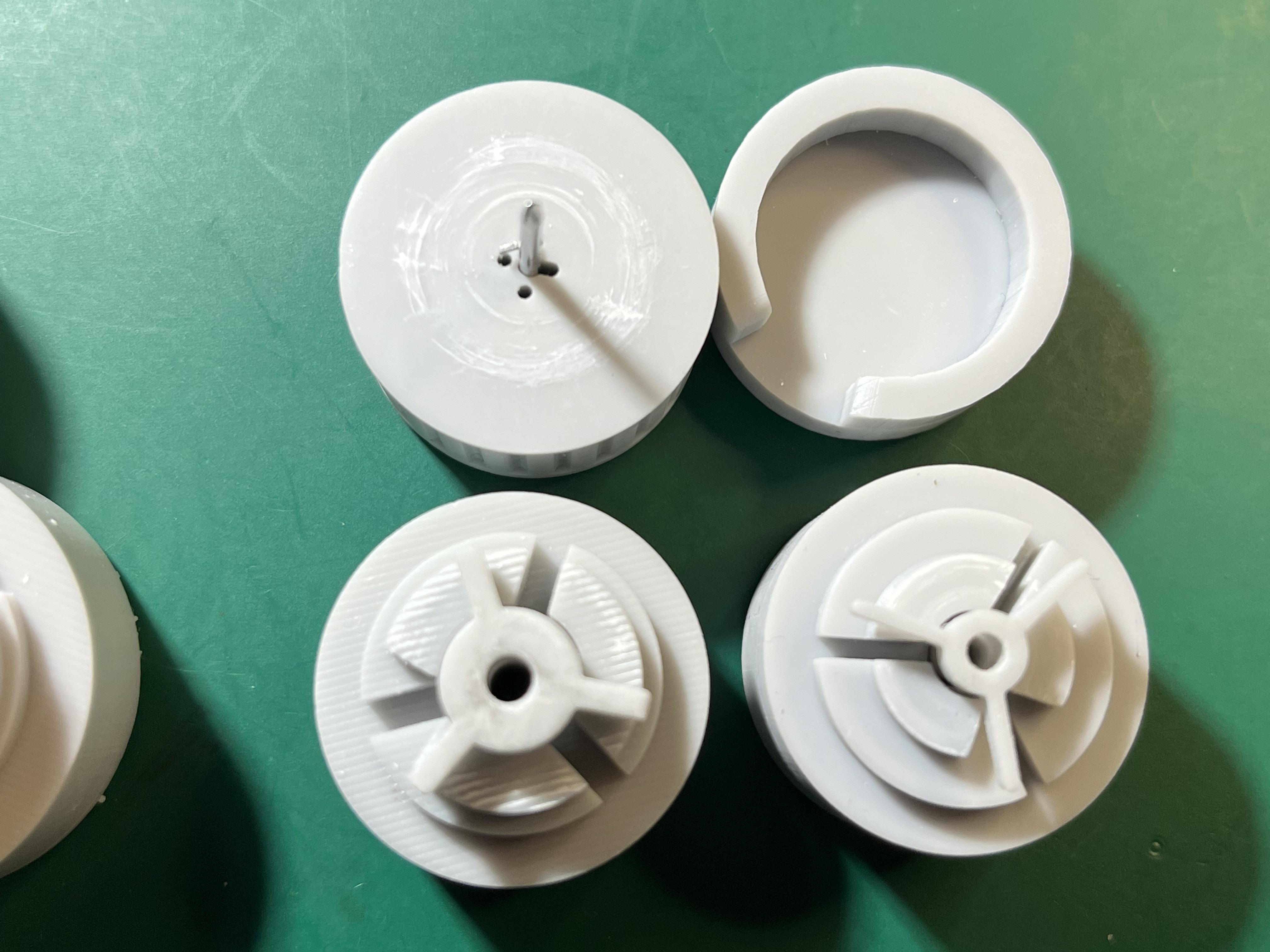

I've done a couple now: one 5.5mm (custom size) and one 14.0mm. They work fine.

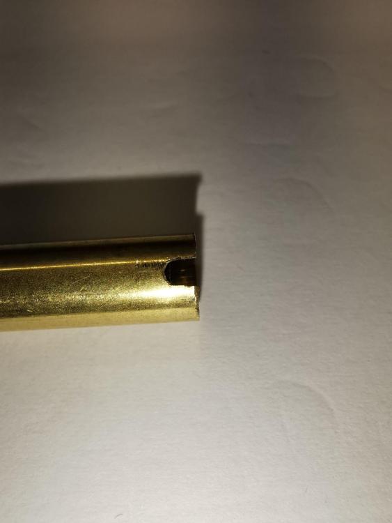

I had previously made one from brass tube with a 3D-printed plunger for a tiny ladies watch (Seiko Rainbow with cal 1104A movement) with a 6mm diameter barrel that was too small for any of the winders in my cheap Chinese set, using an arbor from the set, but when I was trying to coax the tail into the tube it caught on the edge of the cutout and broke off. The RS winder was more successful. It may just be that it was easier to hold than the 5.5mm tubing so I had more control. I'm not sure. By the time I had received a donor movement for that watch (which was needed for multiple parts) I had made a suitable RS winder and had no problems with it.

This is a common mistake when rolling your own winding tubes, happens even when using the Bergeon set. It is just part of the journey. Even if you managed to get the tail in, it will tend to get stuck between the plunger and the barrel walls, especially for tiny movements. This wont happen with the RS winder as the plunger has a special toothed design to prevent this.

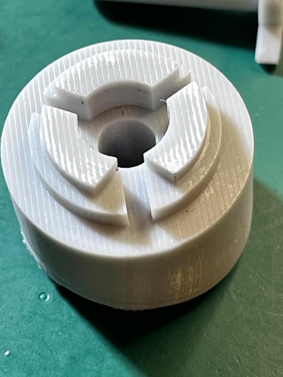

To date I've made three: 14.0, 9.0 and a custom 5.5mm. I initially printed directly onto the build plate, but I had difficulty getting the larger winders off the plate and broke some so I've ended up angling them by 5 degrees and printing with supports (which is why the two larger winders look stripey ... 50 micron layers at 5 degrees gives roughly half millimeter stripes). I printed the 5.5 first and used it once for practice on the broken spring before using it on the replacement, and I've used the 14.0 just once, I think. I printed the 9.0 yesterday and used it twice today (for the same spring ... I didn't notice that the tail was sitting in one of the slots and didn't position it properly in the barrel before pushing it out of the winder ... sproing -- glad I was wearing eye protection!). The spring scrapes the resin a little and I clean the spring before and after pushing it into the barrel (so I get both sides) with some Rodico. There is a little 'polishing' where resin rubs against resin but otherwise the winders look almost untouched and look like they could easily do dozens of springs.
These were printed using Monocure Tensile (https://monocure3d.com.au/product/tensile-industrial-strength-resin/) but the pieces are so 'chunky' that I don't think the brittleness of regular modelling resin is likely to be a problem.

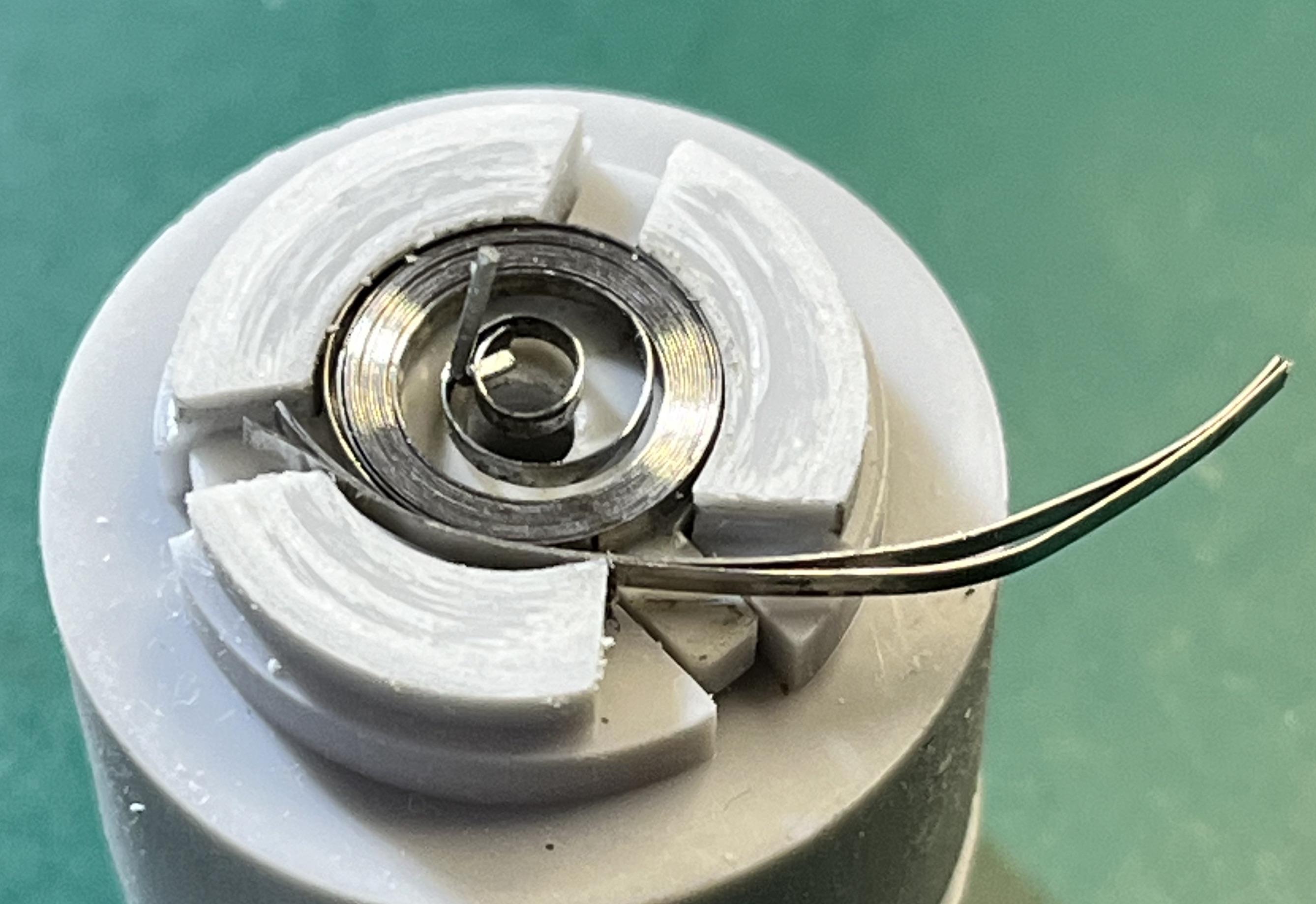

I've done a couple of manual wind springs and feel I have a pretty good handle on winding them now, but I'm not having much success with automatic springs. In my first attempt, I had started to feed the bridle into the winder then when I was trying to wind it in, the arbor end broke (first pic below). Today trying another spring, when trying to 'encourage' the bridle into the winder I realised it was coming out one of the pusher holes ... the whole tail and bridle had snapped (second pic). Just now on a third practice spring I thought I had wound it successfully. I started the bridle in the winder then wound it in before gently releasing the tension. It looked good in the winder so I did the transfer to the barrel. I'd checked that the barrel was flush with the winder housing, then pushed the spring home, checking again that the plunger had come all the way down to the barrel, but as soon as I took the winder away the spring jumped out ... in two pieces, with the tail again broken off at the beginning of the bridle.
I'm rapidly running out of automatic springs I can practice on. These springs were probably all 20+ years old, and the first two might be closer to 40 or 50 so it's possible that it was their time to break anyway, but if it's me, I want to work out what I might be doing wrong. Once the bridle is in position, should I just let the winder pull it in, or should I give it a push as well? The first one I tried to just pull in but it broke at the arbor. The second one I tried to give the bridle a push at the same time as winding to try to ease the pressure on the arbor, but ended up shearing off the tail. I don't know what the story was with the third, whether it was already broken when I tried to transfer it to the barrel, or if it broke as it flew out. Any suggestions?

Follow-up: I've been practicing with another spring from a donor movement and I think I've sussed what's happening.
My first failure may have been because I hadn't started the bridle properly. It wants to go in around the spring in the barrel rather than alongside, and that may be why the arbor end failed before it wound in.
My second failure may be because I was pushing instead of letting the spring draw the tail and bridle in.

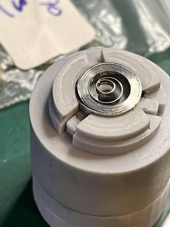

My third failure I think I have been able to reproduce a little less destructively. The end of the spring is not being pushed out but catching between the housing and the plunger. I repeated the process, taking photos at each step to be sure. Below is the pic just after plunging into the barrel but before pulling the winder away. After plunging, however, when I lifted the winder away the barrel lifted away with it ... something was caught. Gently easing the barrel away revealed that the end of the spring was not in the barrel (second pic). I walked the spring out of the barrel and did the winding process again. This time I took a pic of the spring in the winder after using the bowl setter (third pic). Here you can see the very end of the spring, left, has not been properly set for positioning into the barrel.
I think the fix is to re-print the plungers with a snugger fit to the housing.

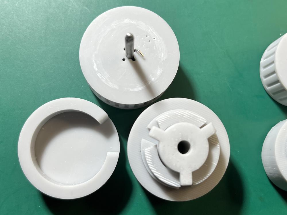

I have had another user report issues when using UV cured resin printed winders instead of the usual PLA/PLA+ material.
  • The root cause seems to be that UV cured resins are rubbery or more "grippy" as compared to the slippery surface of PLA/PLA+/Nylon printed winders. This causes an undesirably higher amount of friction between the mainspring and winder parts while winding, leading to failure and breakage.
  • Another issue with resin materials is that they seem to vary quite a bit between manufacturers, I'm having a hard time pinpointing the exact frictional coefficient numbers (vs steel). There are tough resins, flexible resins, specialty resins, etc, too many to keep up with. Maybe someone can help me with this.
One of the advantages of RS winders is the very low friction when using PLA/PLA+ (vs steel). That advantage is gone when a rubber-like resin material is used.
So as of now, I will no longer recommend using UV cured resin for building these winders. Users should be prepared to deal with it accordingly if going with resin, eg. using lubrication.
PLA/PLA+ materials will remain the default recommendation and optimal way to build the RS mainspring winders. I have updated the README to reflect this.
