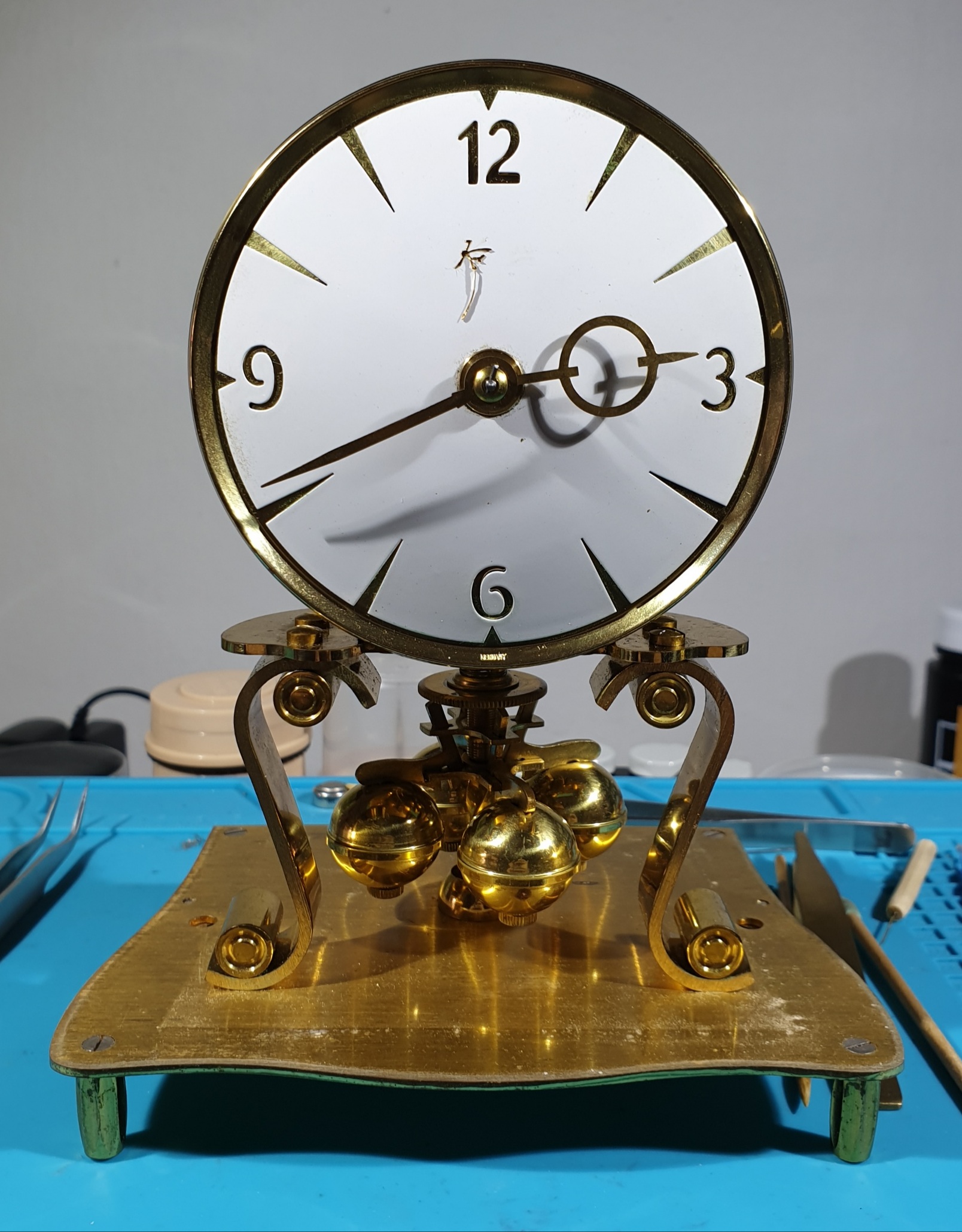

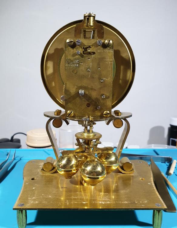

I'll be working on this Kundo clock soon. It was sold as non-working. The suspension spring was there but missing the fork and the top pin. This used a pin instead of a screw because I checked the hole and there were no threads. The clock is grossly over oiled and badly gummed up. The mainspring is fully wound but absolutely no power is transmitted to the escapement.

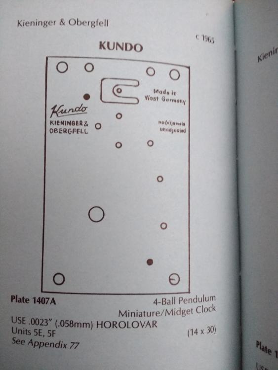

Is this a early model because I can't find any model number on the plates?

Hi HectorLooi looks like a 1965 Kundo Plate 1407A i have attached a photo with more details if i am wrong some with more experience then me will let you know hope that helps best of luck with it
Thanks Willow, I think you're right on the money.
No OH, I think the winding arbor is fine. It's spherical distortion from the lens.
I can't figure out how to remove the clock dial. It has 'T' shaped key that goes through a slot on the bottom plate. I tried turning the hex shaped pillar to rotate the key but it doesn't budge.
This clock would need a lot of polishing work, a lot of the brass is badly tarnished. When re-lacquering the brass, how many coats of lacquer should be applied.
Hi Hector   on my Kundo the fixture is the same they are turned so as to release the dial through the key slot.  I did not laquer mine just cleaned the plates and parts with a mild cleaner, its still shiny and sits in the cabinet with the others.
Would French chalk work on the brass work of the casing?
I lacquered some of the pieces with Windles brass lacquer last week. Till today, the surface still feels tacky and if two lacquered pieces touch each other, they'll stick together.

Hi Hector horolac from cousins, quick drying.
Thanks @watchweasol. But this post is from two years ago.
I got the Windles lacquer instead of the Horolacq because Horolacq is classified as a hazardous substance and is not permitted to be shipped to Singapore.
The Windles dries eventually after a week. I now use a spray on lacquer from an art supply shop.
