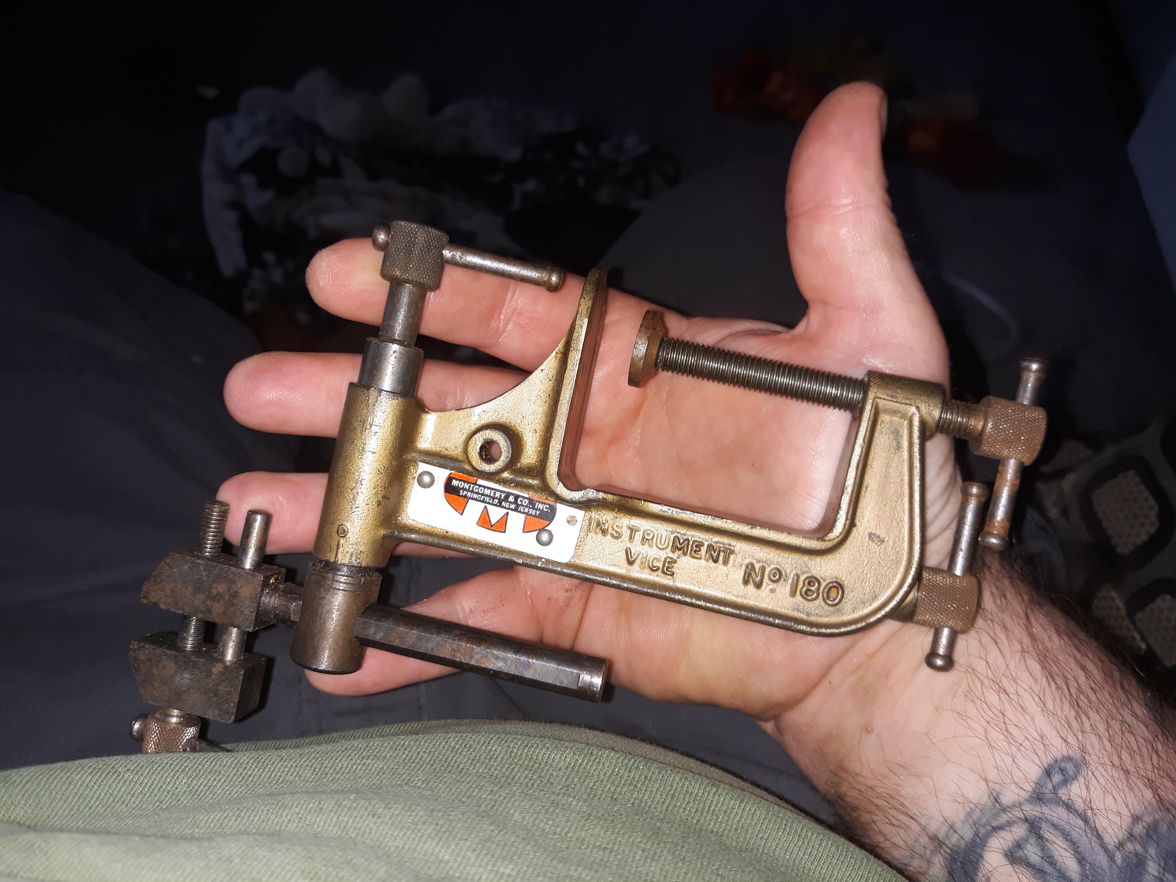

Well it arrived today. The pics don't do it justice it's a terrific little piece and extremely well made. I thought I might have to get after it with my dremel and emory cloth but really didn't have to. Made from tool steel and hardened to a nice gunmetal patina. I took some 3000 lightly to the jaws, added a drop of oil on the threads and that's about it. Snug the clamps down and it is SOLID. Jaws are 1/2 x 1" limited in capacity so I'm happy to report that YES, I'll be getting the 2nd vise added to the collection eventually!
I really like this one!
There are so many good well made small bench vices I don't know why you have to go with the bergeon one which I think is a waste of money or it's look alike which is poorly made.
That G clamp on your hand is tiny. Hope it comes in handy for you.
Me? I'm not buying a Bergeon. Too expensive. The one Plato, JDM and I believe Ash have are more my speed and even then I'll be looking for used if I can find one.
Yes its tiny for sure even for watch repair standards but it was just too cool to pass up and I can use it for other stuff hence the reason I'll still be looking for a regular small bench vise or vice. Must be a euro/american spell thing I guess. I must have a vise vice! Lol

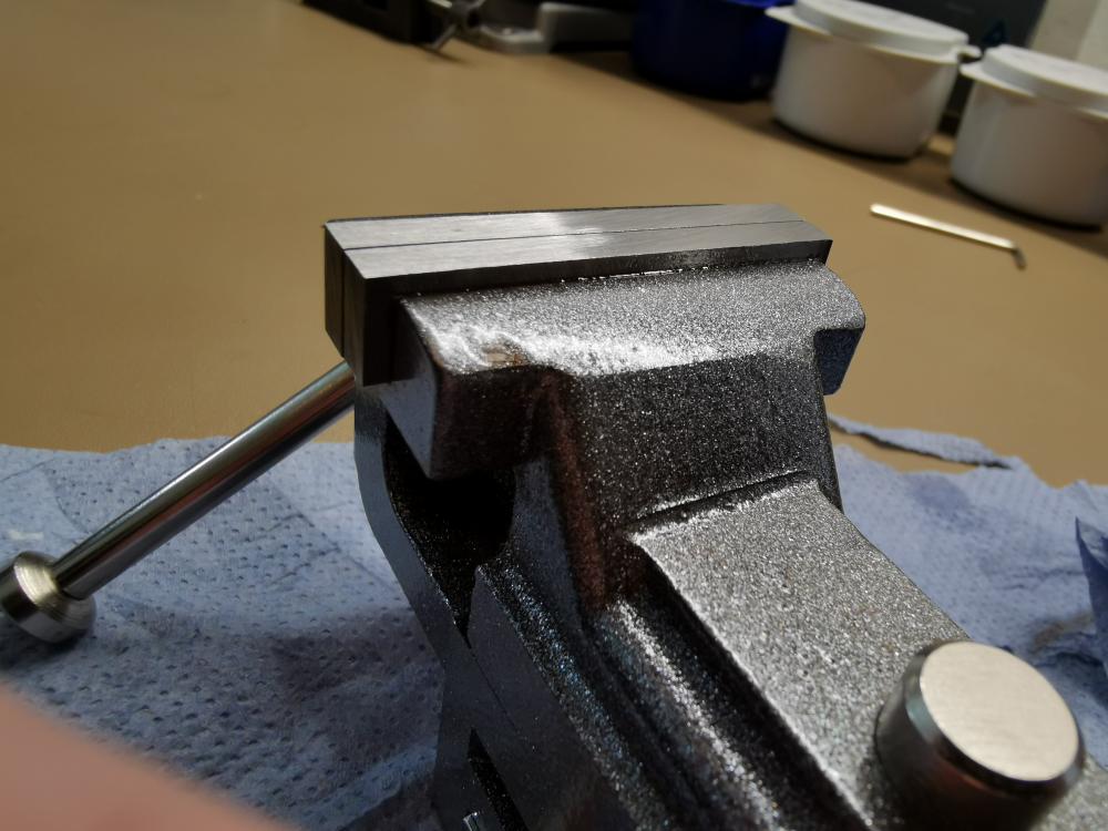

On 7/8/2021 at 2:23 PM, AshF said:
I think you got a dud.  Mine is pretty good.
There is a bit of adjustment if you loosen the jaws... I've got them pretty close now:
Now, draw file to make em flat and parrell! Grab a stick of welders chalk and "dress your file" it'll help with finish and keep your file sharp and make it easier to clean out the swarf and crud when you do. Then dress it again before putting it back in your tool box. Keeps rust at bay.
I'm not sure I need that level of accuracy, I can use the Eclipse for very detail work.

Nah, you don't buddy. That's just me lol draw filing can be alot of work and a pain. I don't do it very often at all. It was taught a long time ago and is rarely required anymore. Yours look great. If mine are that close when I do get mine I'll be letting it go as is for sure. I think there are soft jaws available out there for vices vises too. Get yours mounted yet? Did you see the fold away block that Cousins had available for these? I think Horotec makes them.
