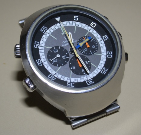

About 15months ago I got my Omega Flightmaster serviced at Brisbane Vintage Watches.  At that stage I didn't have the skills, or courage, to tackle a calibre 911, and I still don't think I'd like to risk it.  I've owned the watch for over 15years and would be devastated if I stuffed it up.  It's in excellence condition, all original hands and dial ... and as you can see below they have a lovely old Patina
I asked about replacing hands while it was being serviced, as the lume only glows for a few minutes ... this is what I was told, and is the attitude towards vintage restorations in Australia at least; it could differ else where.
If the watch is a "Dress Watch", then making them look as new as possible attracts the highest re-sale value.  Which means new hands, replacing the dial with NOS, and polishing/brushing the case to restore it to "As New".
As for "Sport/Dive and Chrono Watches" replacing or reluming the hands, or replacing the dial is a HUGE no no!  Patina on the hands and dial actually increasing the value of the watch.  Refinishing the case is fine; but you will devalue your watch markedly if you touch the hands or dial.  So my Flightmaster was serviced, all crowns and pushers replaced; but dial, hands and case where not touched.
I'd be interested in hearing from other vintage watch collectors and dealers to hear their opinions and market perceptions elsewhere in the world.
