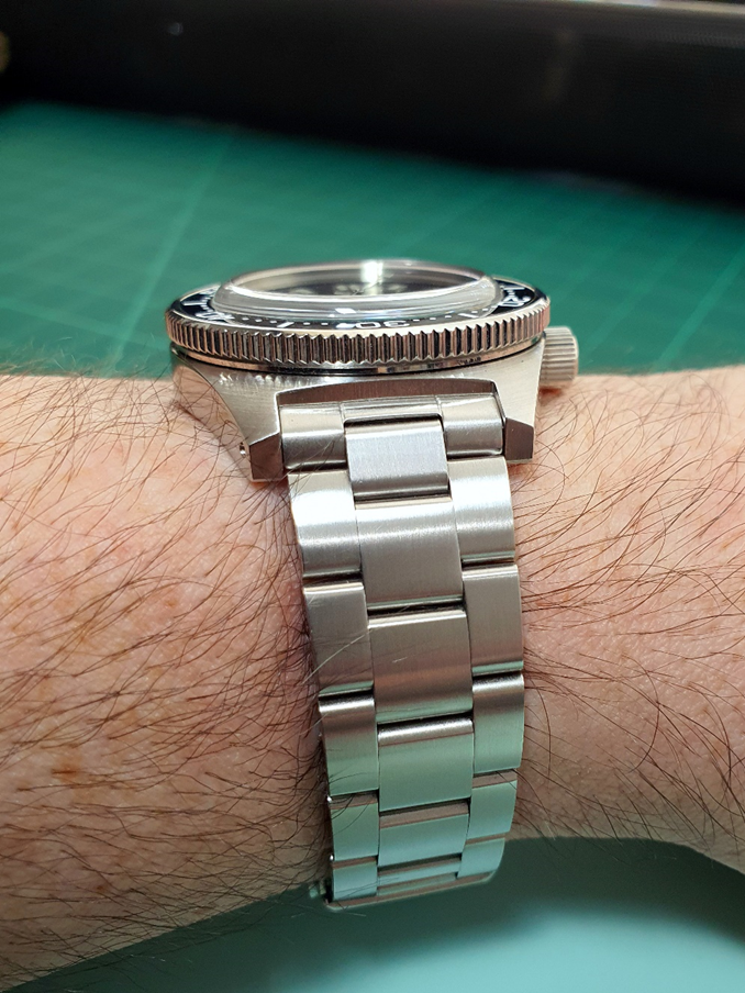

A very belated Merry Christmas and Happy New Year everyone! I finally got around to following this tutorial. And I have to say that it was a thoroughly enjoyable tinkering session that involved the simple tools that I had on hand.
My reason for doing this was to fit a bracelet with female end links to an aftermarket 62mas style watch case. No bracelets with female end links exist for this particular watch case. The case is a scaled up 62mas style case that has nothing dimensionally in common with any of the Seiko 62mas, SLA, or SPB1xx watches. It does however share some commonality with SKX parts. It has a long lug to lug distance of 49.5mm and with solid male end links fitted looked rather long on my 7 ½” diameter wrist. The end link I ultimately used is hollow and from a cheap bracelet that I bought on ebay. The link I made using this tutorial is circled in red below. This connects the case and end link to an aftermarket bracelet for a Seiko SPB1xx series watch.

Not exactly a pigeon pair, but they fit and work quite well. I am still wondering if I should silver solder the inserts in place and silver solder the join on the back…?
Getting ready to fit the bracelet to the end links and case.
And here they are fitted to my home made 62mas homage. It is an assembly of some genuine Seiko and aftermarket mod parts.
Finally, I just want to say thank you to the author of the original tutorial that allowed me to make these links. It was a pleasure to show how easy and fun this is to do. If anyone has a question, I'm more than happy to help if I can. And any suggestions will be greatly appreciated too!
