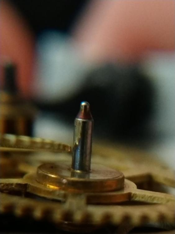

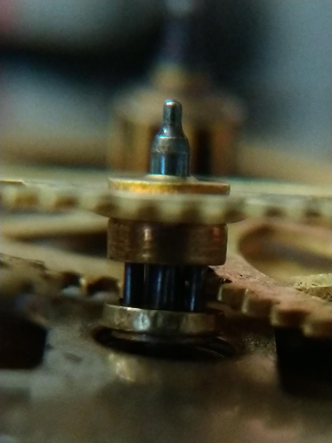

@oldhippy, as promised, here are the images I was able to get.  Made a makeshift microscope out of my loupe plus my phone and the digital zoom, and I got pictures of everything I was able to.  It was a little hard to get images of the bottom of the balance pivot between the hairspring, but I did the best I could.  The pivot does look a little worn on that side.
The blunt balance staff is the problem. With oil in the cups I can't tell if the cups are OK. If you are unable to sharpen the staff then your best bet is to find another. The other pivots on the wheels look OK.

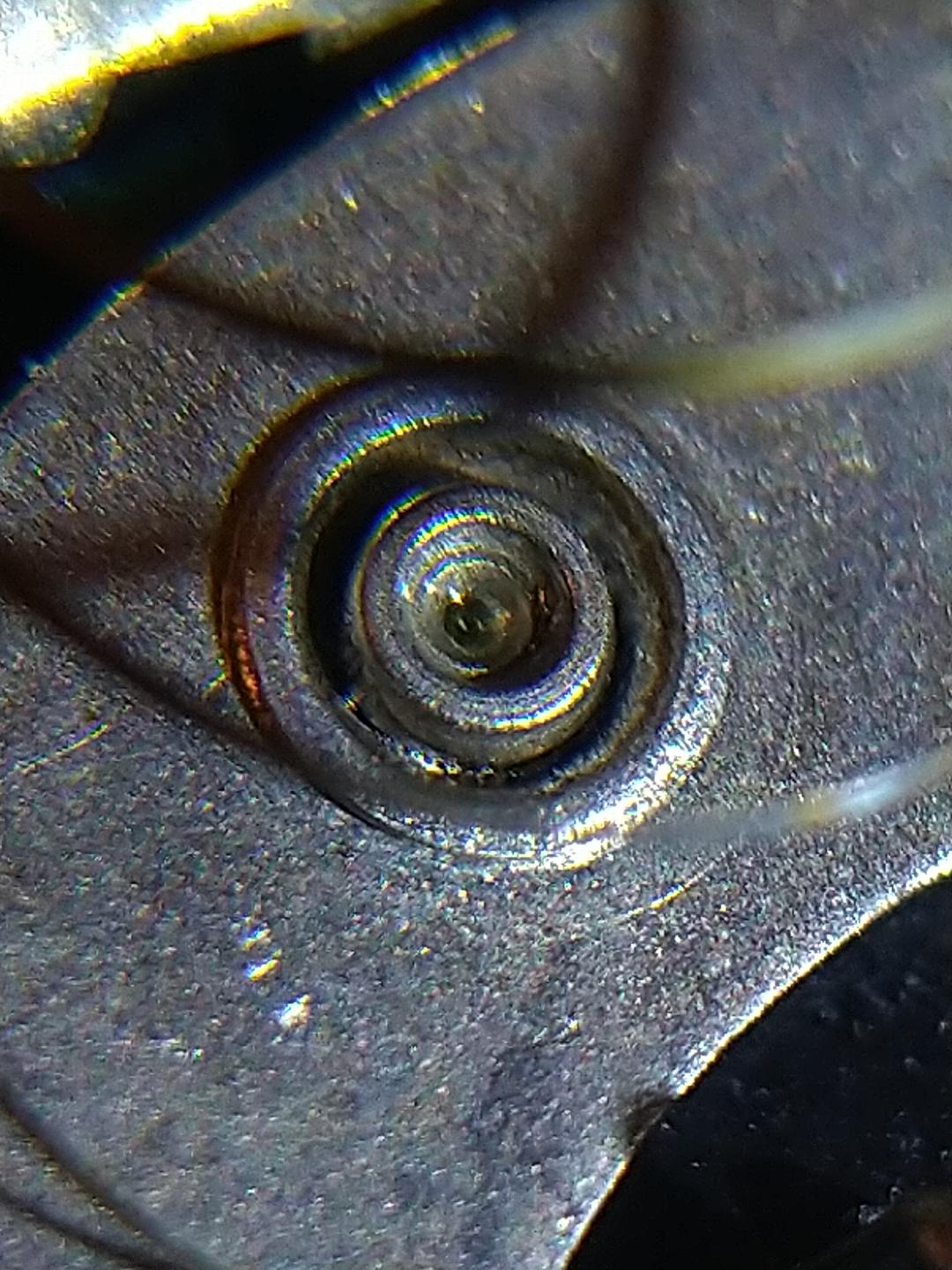

I tried taking some better photos of the oil cups with a flashlight pointing on them.
