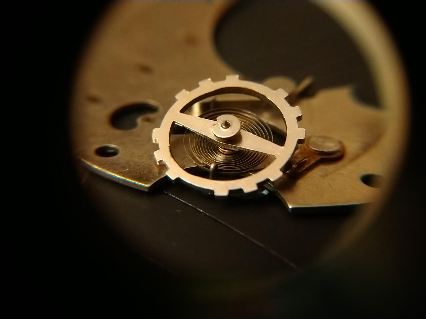

Thank you for the link hippy.  My concern at this point is how to hold the balance in the lathe.  Chucks like on a lathe or a pin vise are good at holding simple cylindrical objects, like drill bits or a cylinder of whatever you're about to cut into.
But a balance is a complex surface and I'm having trouble envisioning how exactly it would fit into the lathe chuck.

Thank you hippy.  I need to grab the top pivot of the balance and sharpen the bottom, but unfortunately, there is practically nothing to grab onto for the top pivot.  The chuck would essentially be grabbing just the conical portion of it, leaving all of the body outside, which I can see as a recipe for something snapping.
Concerning equipment, can this be done in a Jacot?  Lathes with the necessary parts seem to go for a minimum of $350, but I can find complete Jacot sets for ~$100.
Edited by GregG
If the jacot tool you are thinking of buying comes with the Jacot drum you should be able to sharpen the balance but if it only has the pivot holder then the answer would be no as the holes will not be big enough. Can you post a picture of the balance complete.

1 hour ago, HectorLooi said:
You have to remove the roller table and hairspring first to get enough grip on the arbor. You will need a staking set for this job.
I'm not even sure what the function of the roller table is on this balance.  You can't see it from the picture, but the impulse pin is molded into the body of the balance.
It is just a variant of the combined roller you are used to seeing, with the same functions. The roller table, through Interactions with the guard pin, only allows the pallet fork to move when the impulse pin is between the horns. This prevents accidental unlocking. You will need to accurately re-align the cut-out with the pin when you refit the roller.
Sorry for misleading you about the Jacot tool parts. Those I posted are not from a Jacot tool but from a watchmakers lathe. If your Jacot tool is complete you might find one of the rods that can take large pivots.
That balance is different from the old Smith/ Ingersoll P/W. You might be able to remove the roller by putting your tweezers under it and try easing it off. When it comes to putting it back if you don't have a staking set but a pin vice you could use that as a stake, but be careful.
