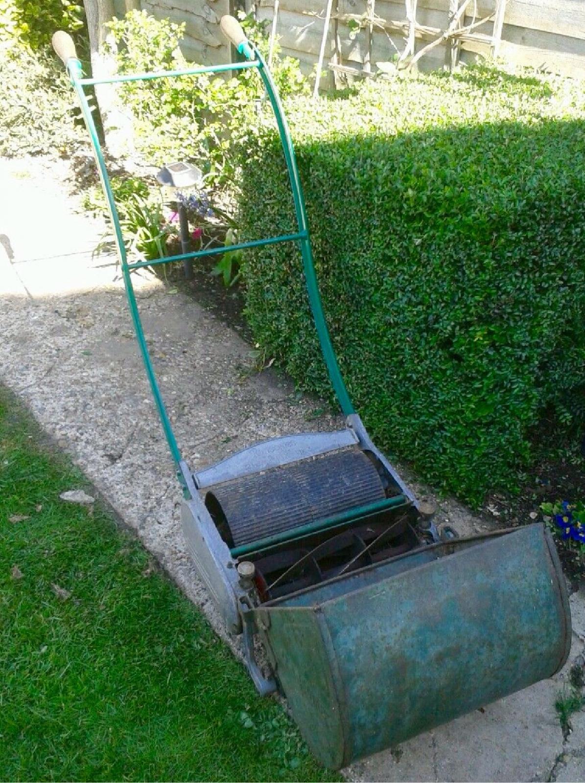

I use one of these, it starts first time every time and cuts better than a lot of the new fangled mowers.
Mine still has "By Appointment His Majesty the King" on it! :)
That's a museum item Geo, almost as old as me.
