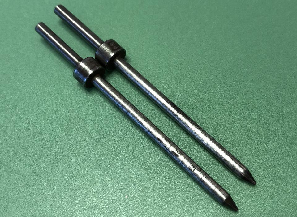

On 9/8/2021 at 10:23 AM, VWatchie said:
These are the two punches (0.1 and 0.15 mm) used to put force onto the balance staff to remove the roller and to drive out the balance staff. For anyone not familiar with the Platax tool here’s an excellent video of its use.
As you can see, the two holes/grooves in the punches are clogged, and I wonder if anyone knows if this is by design or because they have been clogged by broken off balance staff pivots?
Unlike the Platax punches, these roller remover punches from Bergeon’s dedicated roller remover tool No. 30070 have extraction holes so that any broken off pivots can be removed.
What suggests that the Platax punches are clogged by design is that they lack these pivot extraction holes. What speaks against this theory is that the clogged Platax punches will inevitably bend or break the pivots instead of putting the force onto the cone of the staff. One could argue that it really doesn’t matter much but putting force on the cones gives a better and more controlled distribution of the force. Also, why have two punches (0.10 and 0.15) when both will have the same effect, that is, bend or break the pivot?
My guess is that the Platax punches have been clogged by broken off pivots, but that clearing them would be extremely difficult and not worthwhile as the tool can still be used.
BTW, in the video I linked too @Markmentions that if enough people would show interest in a Platax tool video tutorial he could make one. I believe several comments expressed such an interest, including me, so when and if you have the time for it Mark, it would be much appreciated!
I would put a slight flat on the side of the punches near the tips after annealing the tips, then drill through the side so they look like your last pic with holes in the sides. You'll need a V block and clamps to hold the work still and a precision bench press drill with some decent tungsten carbide drill bits. Then you'll find removing the broken off staffs maybe a little easier. You'll then need to harden and temper the tips again afterwards. Jobs a good 'un then.
Or, you could turn some replacements on your lathe (if you have one) from some tool steel and harden and temper them with holes in the sides. I always have a supply of tool steel to make new stakes/punches and various tools.

Thanks for some of the repair advice.  Luckily, the holes are not clogged enough to make the tool useless except for maybe the smallest punch, and the pivot broke off deep enough that there is still a hole, just shallower.  The other two appear to be in much better condition.  I may end up selling the tool once my staking set comes in.
I also saw that Bergeon makes the 30070 tool, which is half a platax, just to remove rollers.  If those replacement punches are the same diameter as the platax punches, I could move the collars over and use them instead.  https://www.cousinsuk.com/product/roller-remover-with-punches-bergeon-swiss?code=R48644
Sadly, I have no clue about metalworking or turning.  Hope to acquire these skills as time goes on, but don't have them yet.
I bought the Bergeon 30070 tool but unfortunately, the quality was so poor (Chinese copy!? Got it cheap on Amazon) I can't get the roller into the slots (extremely poorly made). However, the two punches are well made so I use them with my Platax. They don't have the same diameter as the original punches for the Platax tool, but as the diameter is slightly smaller it still works well to remove rollers. However, when removing the staff I use the original (also clogged) punches, but I file down the pivots first so that they will rest on the staff cones.
