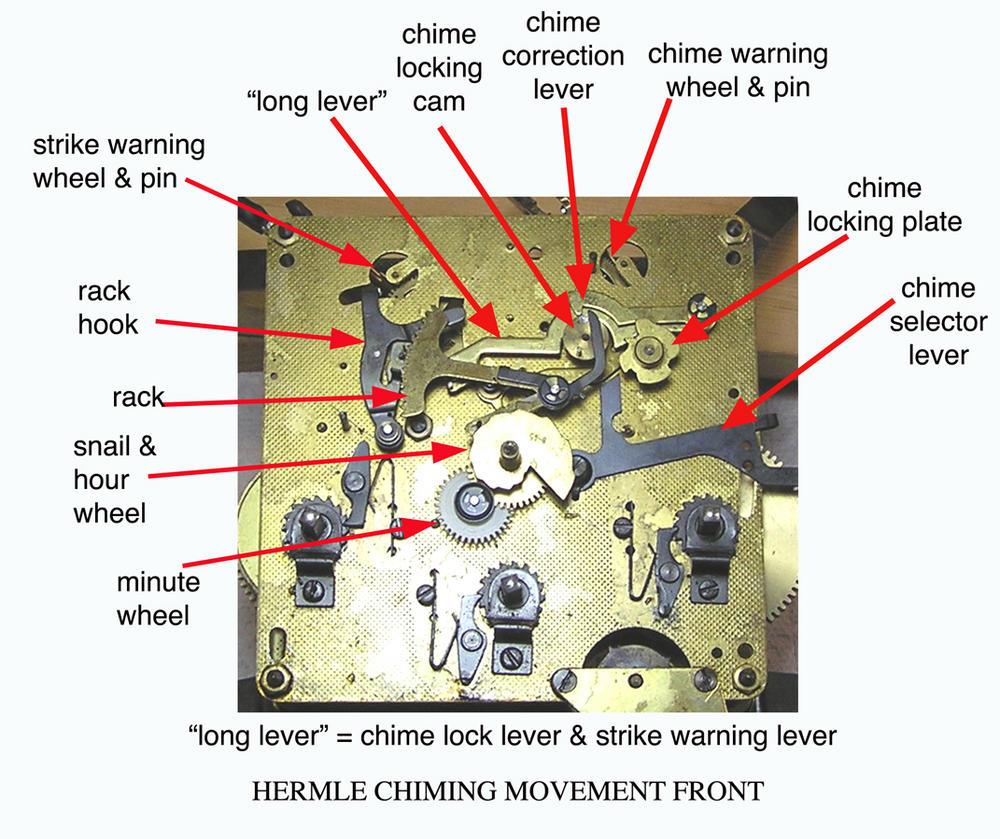

Hi all, first post on here so please go easy on me! I’m primarily a watch collector/tinkerer and active on Wrist Sushi and The Watch Site. I’ve recently been given a Smiths mantle clock with a K7A movement. I can find very little on the web about them so thought I’d try here. The clock is a Westminster chiming/striking clock, but it only chimes on the hour - nothing on the quarters, and no striking of the hour. I’ve attached an audio file of the chime.
if anyone can offer me any advice on what the issue might be, or if it’s supposed to chime like that, I’d appreciate it. My only experience of clock movements was trying to dismantle a Hermle 340 that ended badly after one of the mainsprings let go when I was trying to wind it down - it destroyed the movement and almost broke my wrist… 😁

Smith's 8 day floating balance westminster chime. The chimes sound good and have a good tone. As It is not striking is there power on the strike, is the chime strike silent lever in the correct position (it's the lever at 9 on the dial)  The strike might be caught up somehow and you will need to remove the movement from the the case to check the strike. Do you know how this type of strike/ chime should work?
Both the chime and strike mainsprings were already fully wound and I put about 4 turns on the movement mainspring earlier this week and flicked the balance into life. In the last hour it chimed as per the audio file at 5.15 and struck 4 o’clock. At both 5.30 and just now at 5.45 it repeated the full chime and struck 1 o’clock. And
As you say, it’s a Westminster chime movement but as the audio file demonstrates, it does more than the ‘usual’ Westminster chime would do.
Hi  Unfortuatly there are no picture of the front plate which would be useful as all the control of the chime/strike takes place from the levers on the front plate and the star cam on the center wheel.  The star cam has 4 points on it, one longer than the others this lifts for the hour strike the other three control the quarters and the chime locking cam on the  top right of the front plate controls the duration. Also if the chime/silent lever is at half cock that may cause problems, It is also possible that the pin barrel and drive gears are out of sync. attached two pics of front plates  to illustrate      cheers

Thanks for that. I’ll look to take the movement out at some point and have a look. I know very little about clocks but when I was working on the Hermle that I ruined I remember seeing the rack and snail. I had to return a brand new Hermle movement to Cousins as it only struck ‘1’ no matter what the hour was as there was an issue with either the rack or the snail.
It’s continuing to do the ‘weird’ chime every quarter and strike 1 o’clock. Maybe it’ll sort itself out - it’s been running since the weekend but only recently started striking, so I’ll see what happens. I’ll need to see if I can remove the movement at some point - even though I can’t see the front the mounting points look the same and the chime/silent lever is in that position. Thanks for the photo.
I’ve just observed the hammer sequence. On every quarter (now at least), it chimes the 4th quarter followed by the 1st, 2nd and 3rd in sequence, i.e. -
3124 3213 1324 4213 1234 3124 3213 1324 4213 1234
I notice the sequence is different from the table above? I’ve numbered the chime bars as 1 being furthest away in the phot above and 4 the closest.

If what you have quoted is one continious chime its not locking and the first quarter is a round of one  round  2nd  is two rounds  3rd is three hour is four followed by the hour strike as per OH's chart
