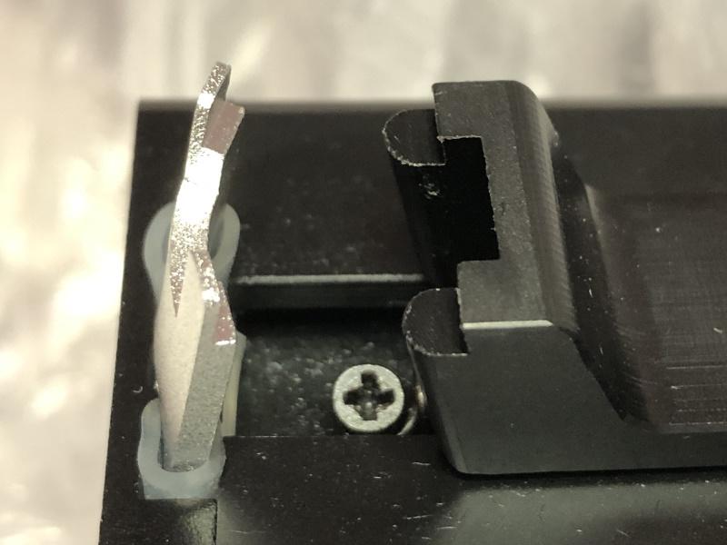

To understand the problem of the microphone I'm attaching a picture. The Chinese didn't quite Clone the microphone correctly. Just a little additional machining on the outer jaws and the problem would've been solved but they didn't.  Which is unfortunately bad because This is how you're supposed to hold the watch if you want the best signal quality.

Do you have a preferred way to hold the movement holder in the timing machine Pick up? If you look at the picture way up at the top he's holding the movement holder sideways is this the way that you hold the watch or do you have the knob of the holder facing out?
So, obviously this has been improved, and would explain why I've never had any problems attaching my movements directly to the microphone on my Weishi 1900 which I bought, I believe, some three years ago. See the below picture.

I noticed on eBay sometimes they'll sell the microphones separate and claim their new and improved but conveniently they never said what they improved. Yours definitely looks improved as that would hold the movement without it falling out.

I just found out that the silver metal piece IS the microphone/ vibration sensor. I had thought that there was a microphone inside the black tube, but some research has revealed that the silver metal piece is directly wired to the circuit in the black tube assembly!
I guess that makes sense why you should put the movement directly against the silver metal holder!
