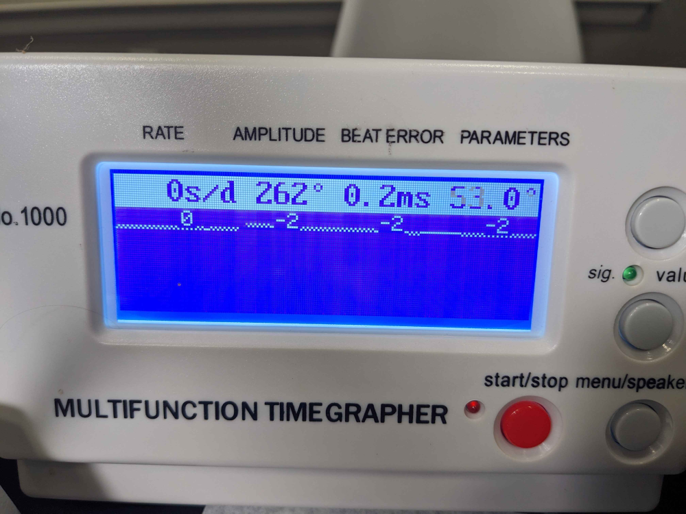

Okay interesting development here ya'll working on seikos should see.  This is again a seiko 7s26 with a general resortes 2377x mainspring.
So my original issue was i could not get over 230 to 240 amp and i was SURE that the bridle was slipping prematurely using 2817. I was also unsure if the generic mainspring i'm using is correct.
I've cleaned and reserviced the barrel now THREE times and here were my results.
1. Did the classic five little dots and flatten them out into little smears. This got me the lowest amplitude and hte most premature slipping.
2. Tried reducing it to three little dots and flattening them. This got me about 10 extra degrees of amplitude but still very little tension on the spring.
3. And now i just did this so i expect amplitude to climb as it settles into the service but somebody here said the seiko spec sheet tells you to make a ring of braking grease across the entire barrel wall. I did four little dabs, and smeared it across the whole barrel wall as best i could. Wound it up and TENSION, like...normal tension i would expect.
I threw it on the timegrapher and got the same damn 230ish amp and just let it run for 20 minutes and sat there and watched the amplitude climb higher and higher. My oilings probably all messed up since i've assembled and disassembled so many times but look at this.
The delta is shit of about 35 seconds but now that it appears my amp issues might be solved i can reclean and lubricate and then i'll check the hair spring and worry about the delta.
The ring technique WORKED.
