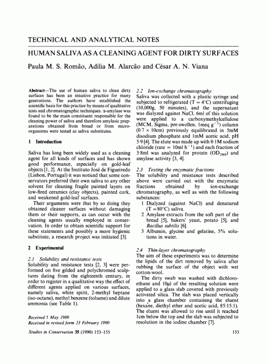

Hi there LittleWatchShop ,on that particular dial I would go no further than saliva (enzyme solution ) on a q tip .It will not remove printing and lacquer only dirt and leave it at that. But don't do it after eating chocolate and drinking coffee or you might end up with a tropical dial 😄
