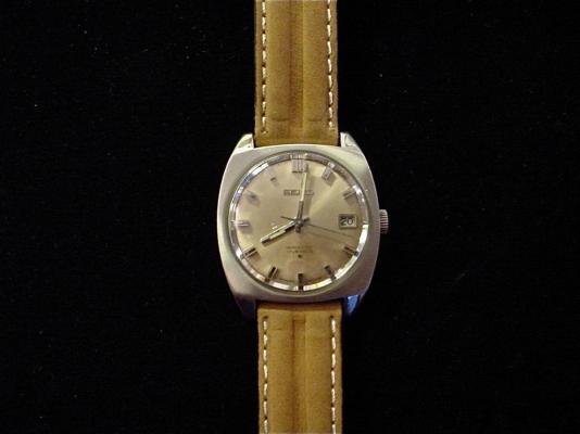

Here is the Seiko 6602 with a different dial and watchband along side a Vintage Hamilton Pan Europ I am working on . A new crystal is on the way for that one and I am thinking of sending the dial to someone for a professional refinish .
Excuse my inferior pics . I will have to get a better lighting set-up .
