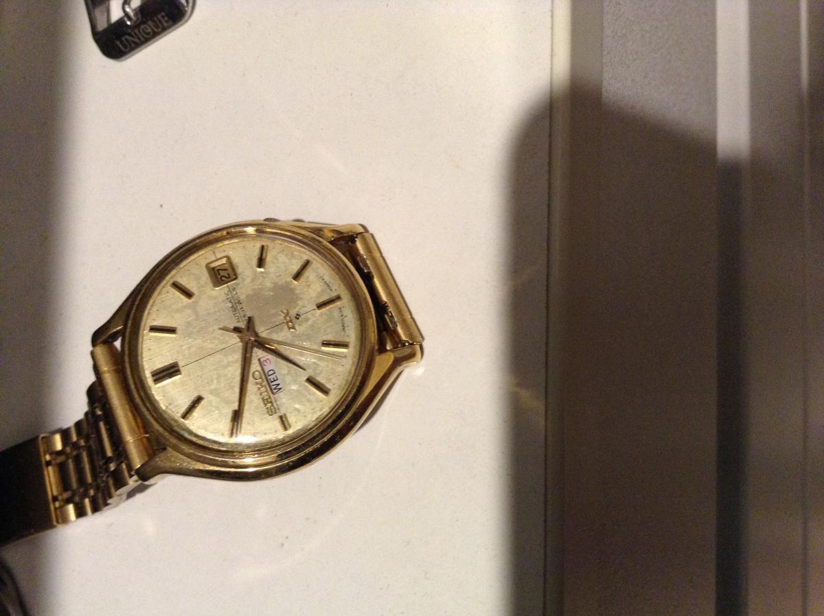

Probably is a no go Cunningham as Seiko tended to print on top of the varnish, you could try to carefully peel back a small area on the edge & see what comes with it. If the print stay in place you could try this http://watchguy.co.uk/cleaning-and-preserving-original-finish-on-dials/ although the results are somewhat variable.

Bought this chronostop 146.012 off ebay. But before I send the dial to be restored, as soon as I'm back from Turkey I'm going to give it a go with the car polish trick. Any thoughts? 306230e067b2563d0eeebe376344117a.jpg

The only thing I've used so far is rodico. It really only cleans dirt and doesn't get extreme like some of these shown. As stated, there are too many changes of ruining the wrong dial.
Even with radico you have to be very careful so as not to pull the transfer off. Reading some of the ways people clean dials I'm lost for words. If a dial was in such poor condition I would have it restored.
Hardly worth spending £100 on dial restoration when the watch is worth less than that, also I notice that most restorations are rarely the same as original - wrong fonts being the most common problem.
