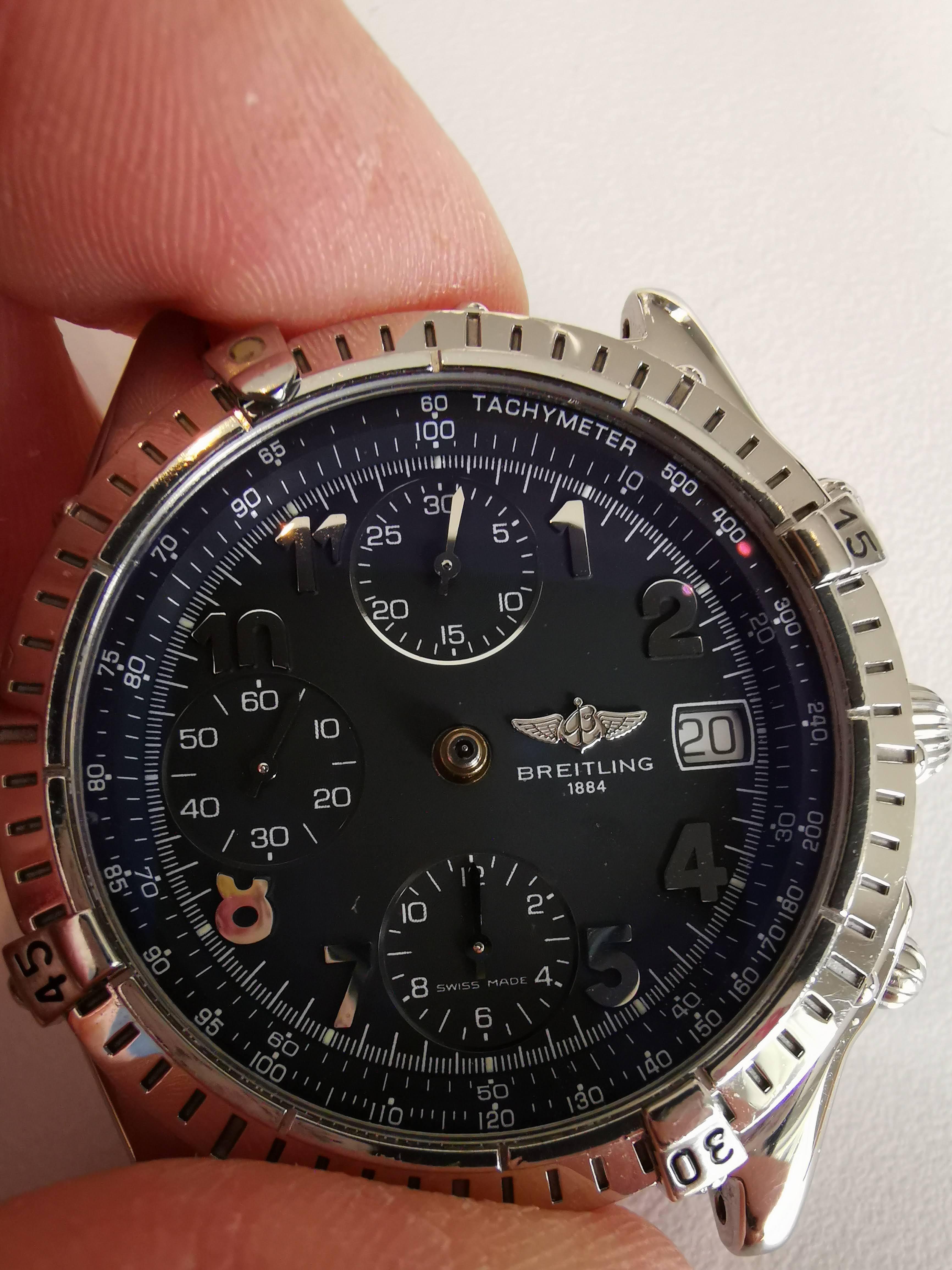

7750 chrono minute hand question
From the same listing, the back side: I would guess that the back pops off rather than the front. You can see a little groove there where the caseback sits over the winding stem, rather than a case tube. Look for an indent or notch around the back. It might be possible to pry this off from almost anywhere on the back if it sits right against the rubber strap. The movement looks like it is from the Ronda RL family (015 or 115 or something? I forget which numbers have a calendar and which don't)
I'd expect a similar notch somewhere around the rear to pop that off.
