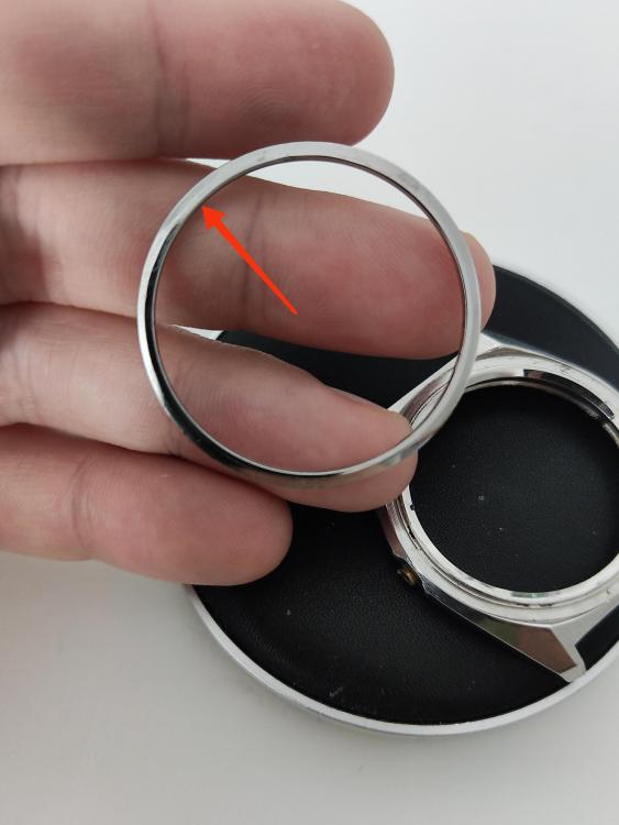

During this months I've started my journey. While I'm doing pretty well with movement and mechanics, I had and I'm having troubles with an old orient case.
First of all, I've not been able to get the crystal out without braking it. Than I thought that the "bezel" (I don't know if I can call it bezel) was pressure fitted into the case, but it looks like it isn't. So, is it possible that this kind of bezels are glued? Do someone know how should I try to reinstall it and with what kind of crystal?? Here's some photos that I hope will be helpful.

It is a bezel and you shouldn't glue it in. I'm guessing it'll press fit into place with the crystal in position, not without it.
Okay, that was my first guess as well, but I think I ordered the wrong glass because it didn't work. Do you know if I need a special type of plexiglass, what is it called? For the measure, should I take the inner diameter of the bezel or the inner of the case? Thanks a lot Plato!

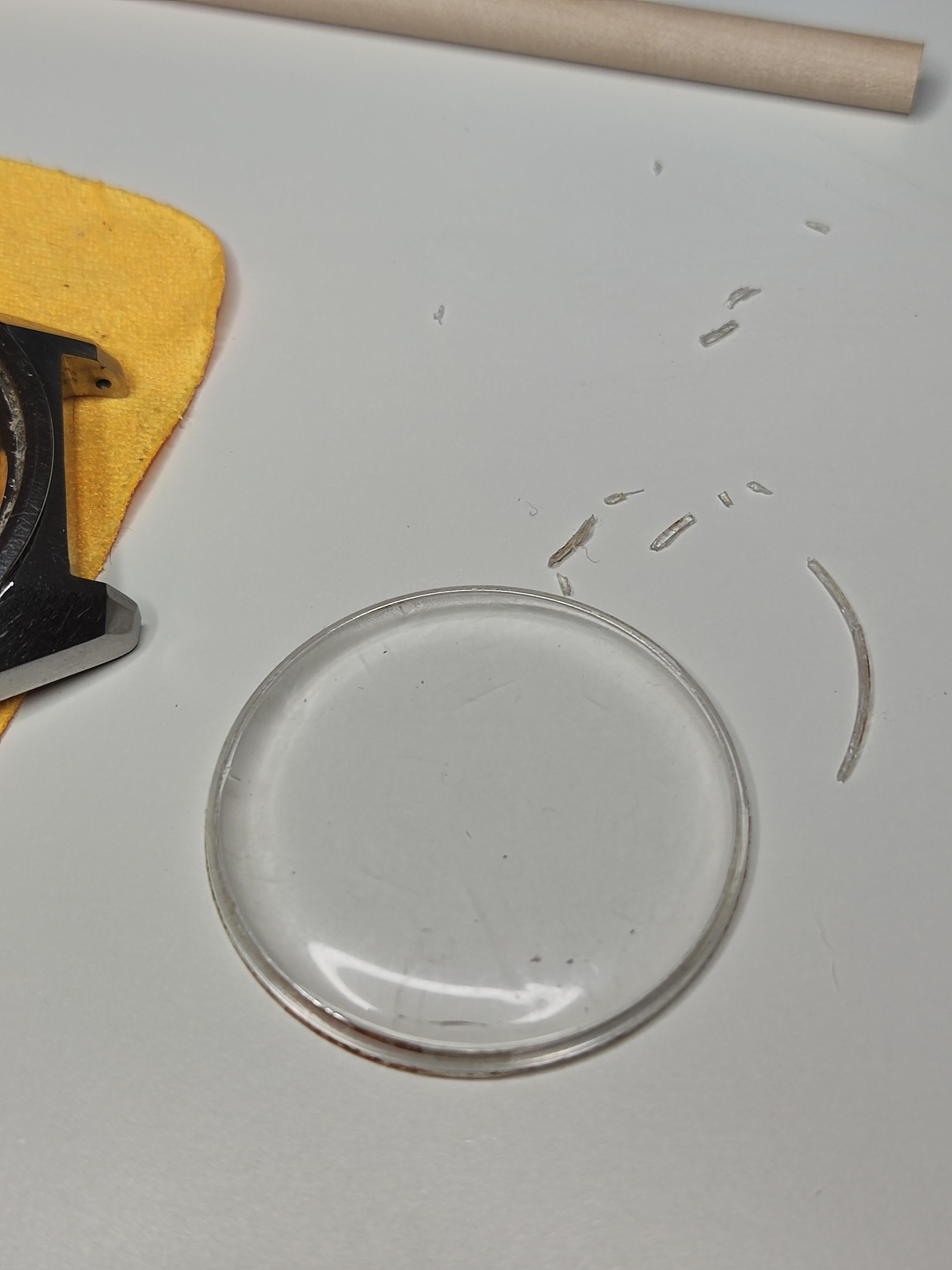

Well, the old one is destroyed. And I destroyed it whil trying to remove it, possibly because I used the press the wrong way, or because it was too stuck. I don't know.

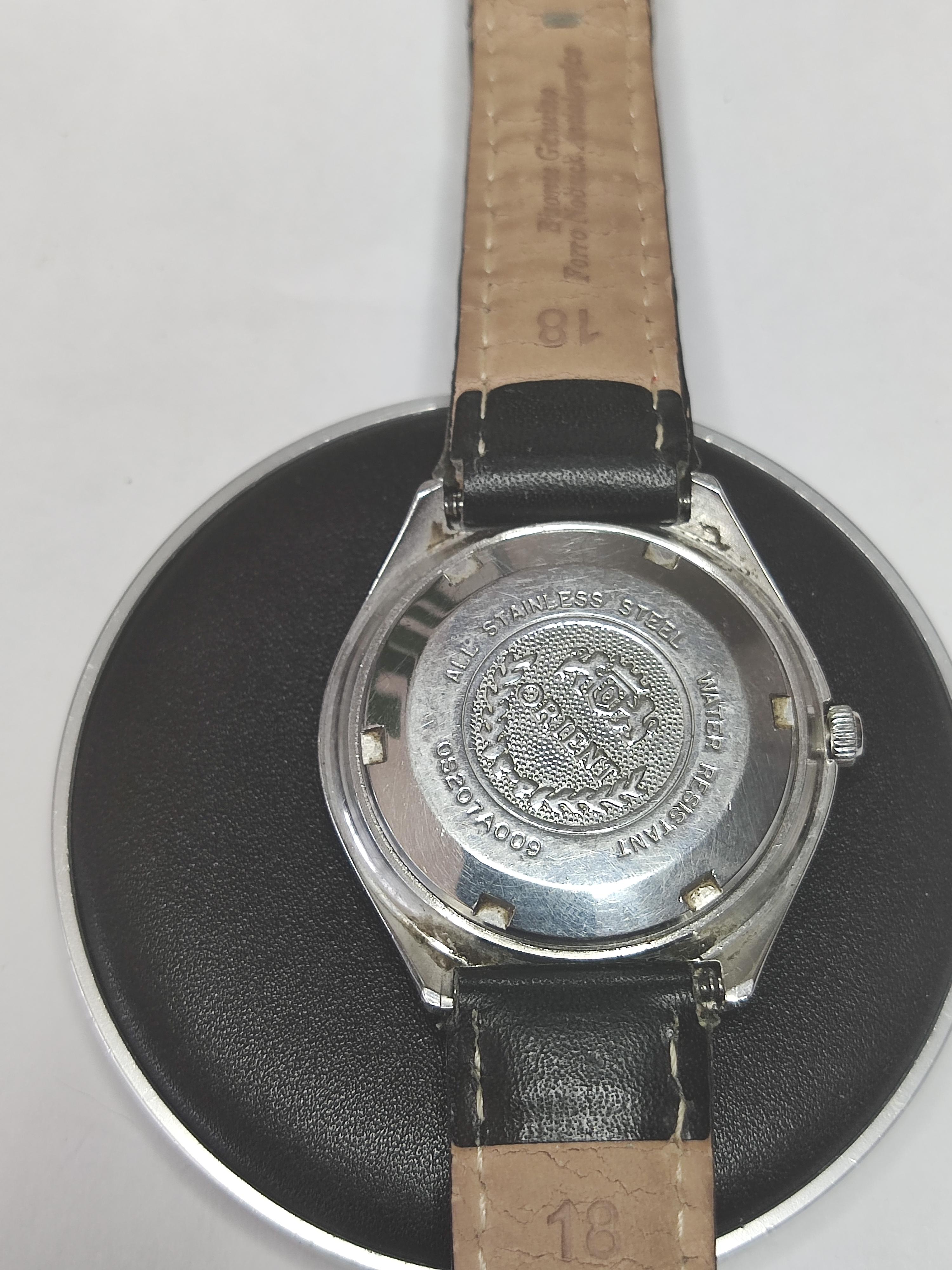

That being said, case is a OS207A009.

This looks like an case with an exterior tension ring to hold the crystal on.
The flange on the outside edge of the crystal, as in the drawing jdm linked to, should fit outside that raised lip on the case.  The ID of the crystal should be sightly smaller than the OD of the case lip.
Then the bezel/tension ring fits over the crystal. So the OD of the crystal flange should be about equal to the ID of the tension ring.
The flange on the side of the crystal is now sandwiched between the case and tension ring.  Without the crystal there, the tension ring is much too loose.

It has happened again. So, shame on me.
Totally different case, from a Swiss made Kowal from the 70s.
I analyzed the case for 3 days. "This is press fitted, for sure". So I took the press and...crack. Again. That's very frustrating.
I just don't get how am I supposed to remove the damn glass. Seriously.
I leave here some photos. I still have not been able to remove all the glass from the case, so the -supposed to be- tension ring is still in place.
Please, someone help me understand how this works and how can I notice it before destroy all my crystals.

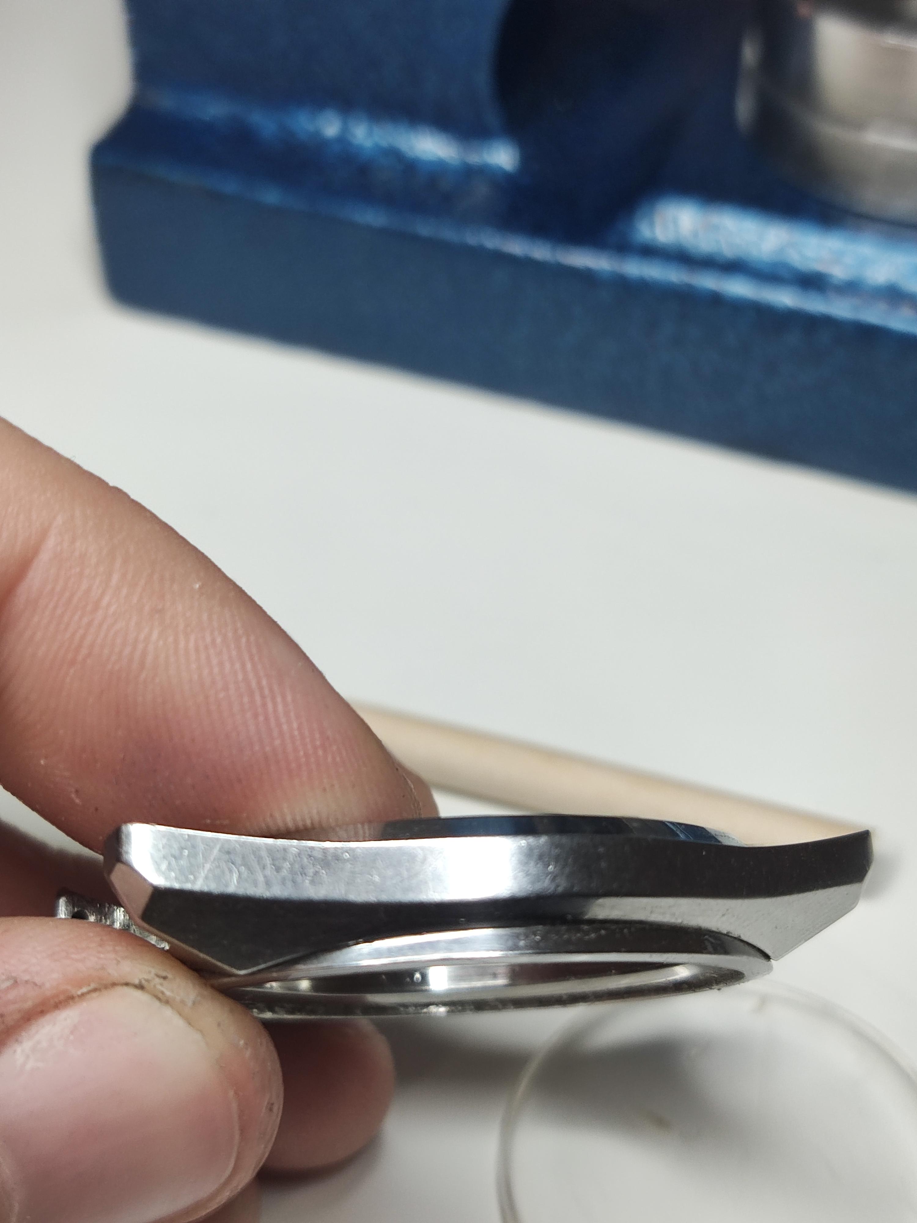

It is very hard to tell. But it totally looks like it was. Impossible to get the ring off in this case, I'll show you:
As you would probably see the ring goes totally inside the case.

You're going to have to get that bezel off in order to correctly fit the replacement crystal.
If you look between the strap lugs is there anywhere for a case knife to pry?
You have posted pictures of two different watches, compare below.
One the second one, the bezel is removed by pressing a suitable die from the inside, however likely that is not necessary in order to replace the crystal.
Please clarify on which watch are you working on and with which objective.

Well, no. But! You where right even if there was not a groove, pushing with a case opener between the lugs made the bezel to come off. Now, the only remaining challenge will be to find a replacement crystal and..never ever do the same mistake a third time.
OK that's great.
If what you've got is what I think it is then you want the Sternkreuz ST, Domed Top range which you order by outer/inner diameter.
Check out here.
The idea is that the crystal is sandwiched between the inner diameter of the bezel and the outer diameter of the case, making a very secure and water tight fit. With this type of crystal no press or crystal lift tool is of any use at all unles you get the bezel off first, and then the crystal should simply push off the case.
