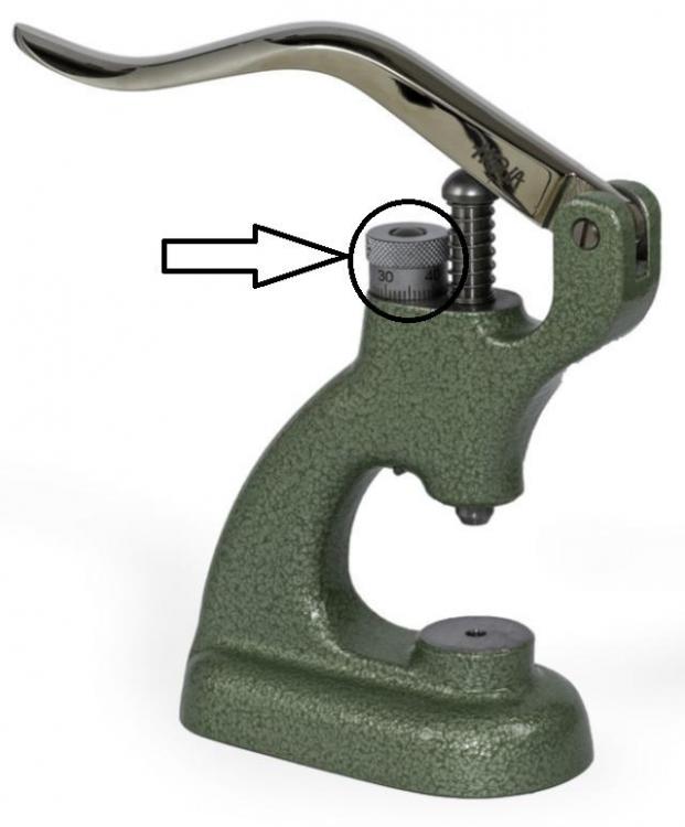

@nickelsilver Would you be able to explain how the micrometer stop in the horia lever jeweling tool works? The favourite jeweling tool has the head of the spindle resting directly on top of the micrometer nut/stop to limit the depth the spindle can go, but the Horia lever-type has a separate micrometer stop.
In the Horia lever-type, is the micrometer's threaded bolt unable to move vertically, fixed to the jeweling tool; and the NUT can be adjusted in vertical height to act as a stop for the lever.
Or is the threaded bolt free to move vertically, adjusted in vertical height by the micrometer nut being turned. In this case the HEAD of the THREADED BOLT comes into contact with the lever to act as the stop; the micrometer nut just acts to adjust the vertical height of the threaded bolt.

On the Horia, the micrometer barrel rotates but remains in position on the tool, the male threaded stop raises and lowers.

Does the weight of the threaded bolt and micrometer nut/barrel keep the assembly/barrel in position on the Horia tool? If not I would imagine unscrewing the barrel would lift it up the threaded bolt, leaving a gap between the micrometer barrel and the Horia tool.

5 minutes ago, ifibrin said:
Does the weight of the threaded bolt and micrometer nut/barrel keep the assembly/barrel in position on the Horia tool? If not I would imagine unscrewing the barrel would lift it up the threaded bolt?
There's a coil spring in the male part, which pulls it down. The male part is also keyed so it doesn't turn. In practice I prefer it without the spring, I like the feel better. The lever pressing down keeps everything in place.

THANKS SO MUCH! I was spending so much time perplexing over how this micrometer works! Do you have a picture of how the spring which pulls down the threaded bolt looks like? I was looking at the spare parts of the Horia trying to figure out how everything fits together.

It's a one piece cast iron casting. The spring is pinned in the male micrometer thread, and the other end is captured in the frame of the tool as in the previous pic. Here you can see the spring, pin, and hole the pin goes in (and underside of the tool).
