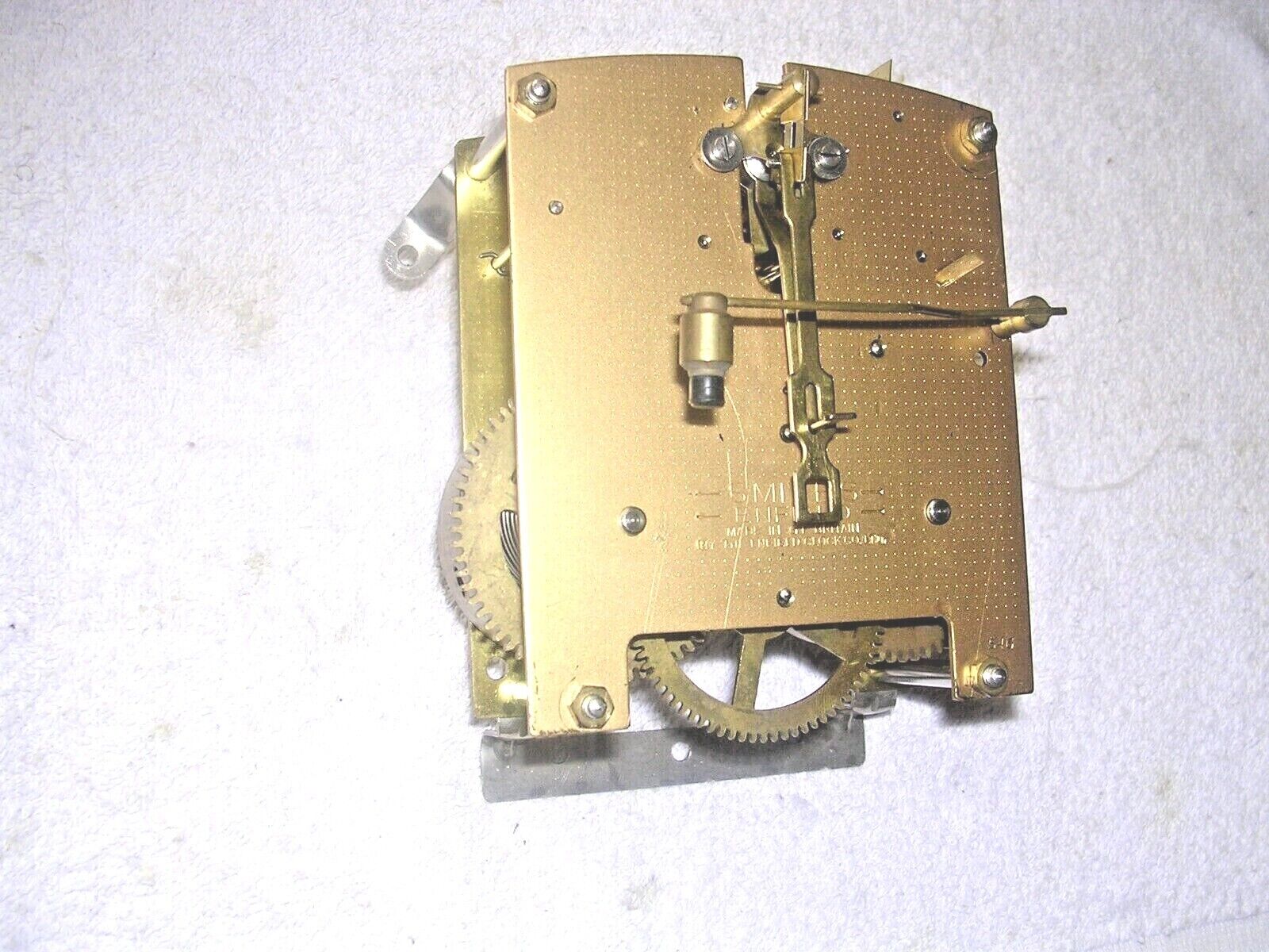

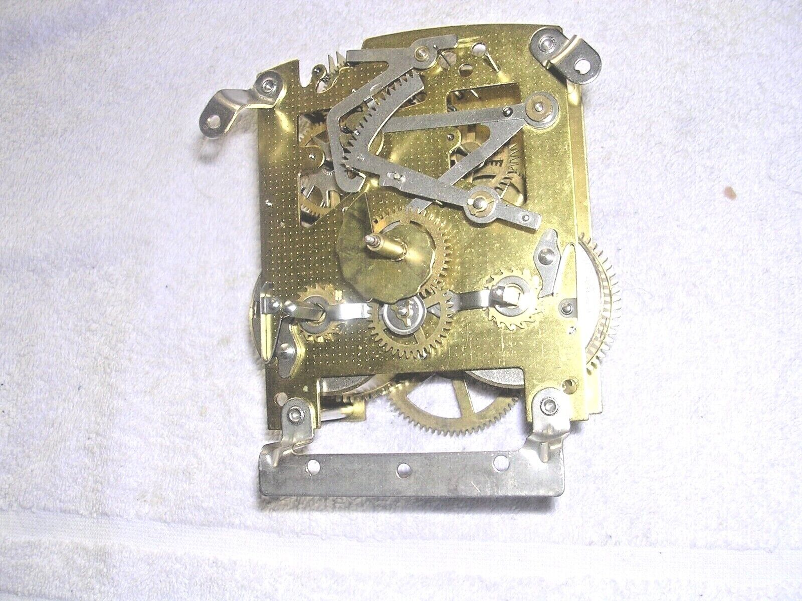

Hi If your clock looks like the image s  attached  all the count work is done via the snail cam (on the center shaft) the gathering pallet, the rack, and the strike wheel. once the warning has released its stopped by the long lever, when the center cam drops its lever the long lever falls an releases the the warning wheel and the count starts. The lever dros onto the snail which controls the amount that the rack drops and the gathering pallet then counts back the appropriate number untill the sequence is counted and the rack is back in the locked position .  No physical count wheel like the American Ansonia clocks.
The last photo gives you a good clear view of how the wheels go into the plates. See my list of the strike side and look at the picture and try to remember it. The going side is
Escape Wheel
Intermediate wheel some times called the third wheel
Center wheel
Great wheel going side
Barrel
The great wheel on the going side is much larger then the one on the strike side so remember that.
This is the most common set up for wheel trains in clocks. As I said you do come across odd counts which will add a wheel or in very rear cases less wheels.
Barrels, caps and arbors. Mark the barrels and caps before taking them apart with a marker pen or similar always keep them away from each other.
Thanks @oldhippy. My time as a fitter would have automatically had me keeping barrel assemblies and springs together s sets anyway, but the info is great. Thanks.
Your descriptions of the wheel trains makes understanding the picture much easier. Thanks for that.
