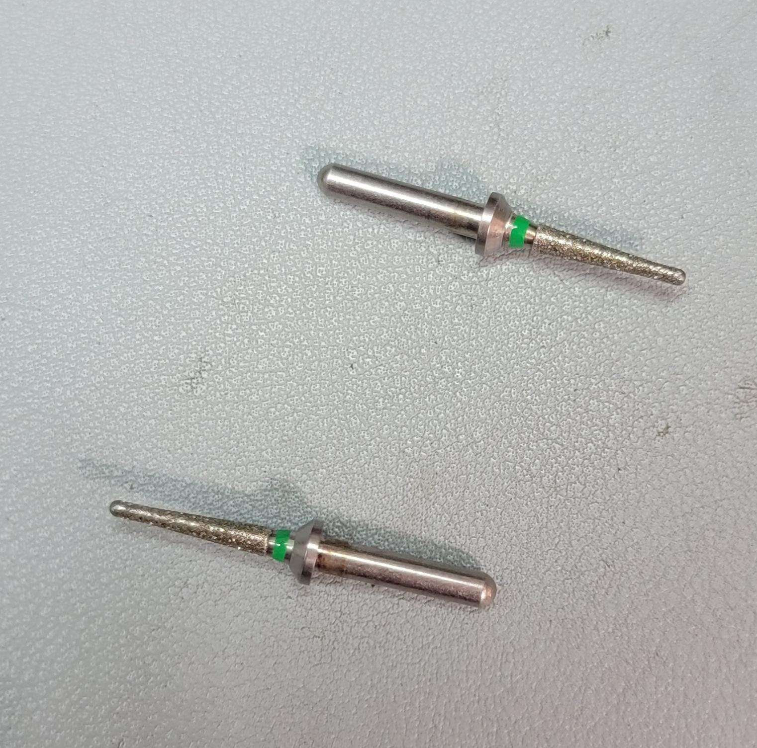

I was at the dentist this morning.  Looks like I need a crown.  Dentist makes the crowns in house using a milling machine, so I asked to see it.  Lying next to the machine were a bunch of these bits.  He said that they are one-time use and he was gonna throw them away.  Instead, he is happy to give them to me.
Hmmm...now wondering how I will use them.  They seem like great little routing bits.

I have a handful of these. I chuck them up in my Dremel and used them for inlay on guitar/bass fretboards. Works best in harder woods, and on the inlays themselves (metals and shell mostly, occasionally bone) and only for really fine detail/cleanup.
Yeah, I chucked one on to my dremel and etched some glass.  Your application is a good one.  I play my guitars...rarely have to mod or fix them, but these will be in my back pocket if I need to.
We use similar bits quite often. Longer and more slender, but almost the same.  Very handy for touching up the sides of a set bridge after hardening and tempering,  removes the blue and machining marks. I could see a dental CNC machining molds or mold forms with them, maybe some ceramic?
