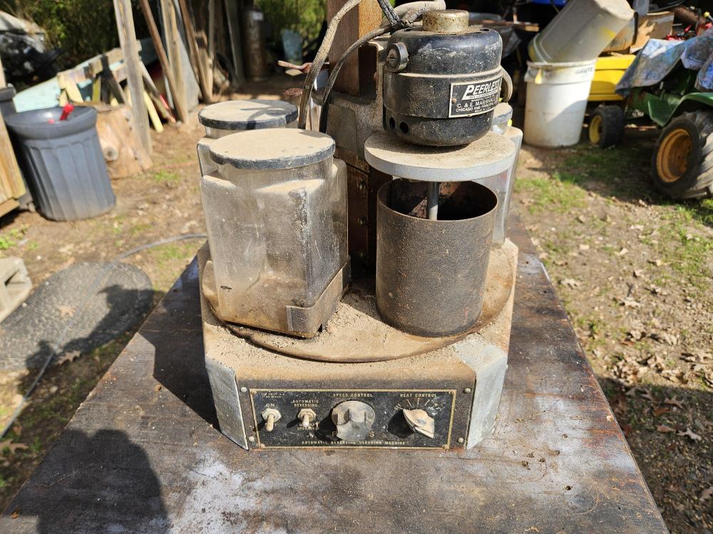

Restoring a Peerless cleaning machine as a winter project.  It was clearly in very rough condition when I saw it online.  I figure what the heck lets give it a shot and I was able to come to an agreement with the seller.  Once the package arrived I saw the box was ripped and the corners blown out.  Yikes!  Damage wise I found part of the base had cracked and the on off toggle switch snapped.  But, the seller provided full refund so off I went with the restore.  First step was to "defunk"  the years of dirt and grime of which there was plenty.  Next to disassemble and take note of what task lie ahead.  Clearly there s more cleaning and painting but the biggest concern is the condition of the control system and the main motor.

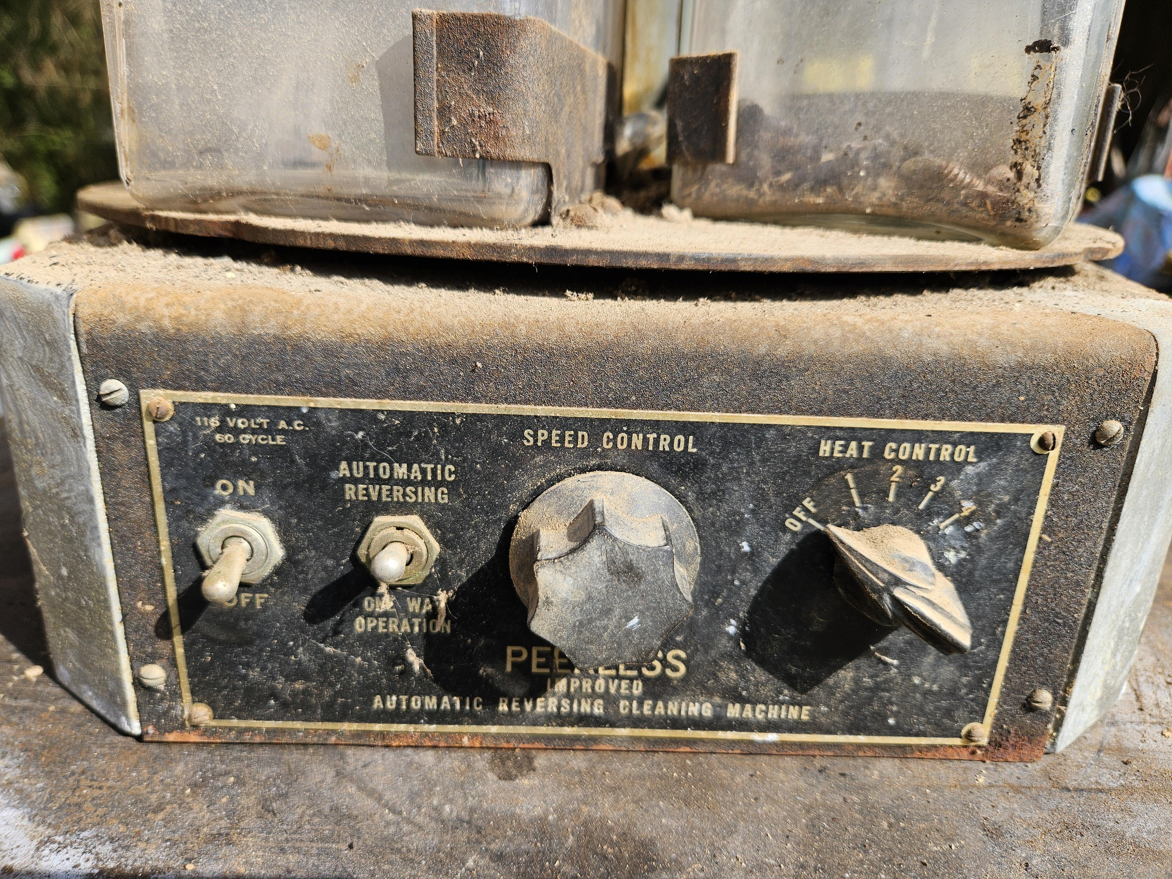

Here are some pics of the control.  I think next task I will take on it to deal with the cracked frame corner. More to come.
the machine came as pictured without any jars.  I did already start to search for suitable replacements and have some leads.  Progress thus far is that the machine is all taken apart and the cleaning continues.  First up were the platter bearings. They were gummed up with old grease and oil.  A bath in mineral spirts, followed with acetone.  Next a little wd-40 and they are spinning free again.  I will clean them once more in the acetone and use a bearing grease when putting them back into place.   Tomorrow I'm going to stop by my auto mechanic to see if he can braise the cracked piece back into place for me.  I also have to pick up some rust remover  to clean all the other hardware.  My goal is to make the machine functional and to keep an aged used look.

quick update- restoration is progressing and now I am working on the electrical system.  I began with cleaning and oiling of the heater\blower motor.   I have realized a insulator that hold the heater coil in place is likely missing.

Worse case is I can't used the Auto reverse  feature.   But, of course I do have to check the main motor as well.  That is next up on the to do list.
On 12/21/2021 at 7:59 PM, LittleWatchShop said:
So is that acting as a solenoid, changing the gears to reverse? I thought it was a motor.
On the front panel there is a toggle switch labeled "Auto reverse".   The way I see it is that as the electric motor spins it turns a series of gears.  At the end of the gear train there is a shaft with cam attached to it.  As the cam turns it engages and disengages two switches. Those switches lead to the 110 AC that goes up to the main motor.  So I'll say the end results is the motor spins in one direction and than reverses the direction.  This helps to agitate the parts in the cleaning solution.  How long it spins I'd say is related to the gear train.
My current thought is if I can find another motor that I can remove the coil from and refit to this one.  No matter, how it turns out this project is fun and giving me a good challenge.
I've been looking at the photos and just can't figure out the function of that coil. It doesn't appear to be a solenoid. Another thing I noticed is your multimeter is set to the 200R range. That could be a little low if that coil is some kind of servo.
Can you figure out the function of the coil?
Also  have you checked the microswitches?
