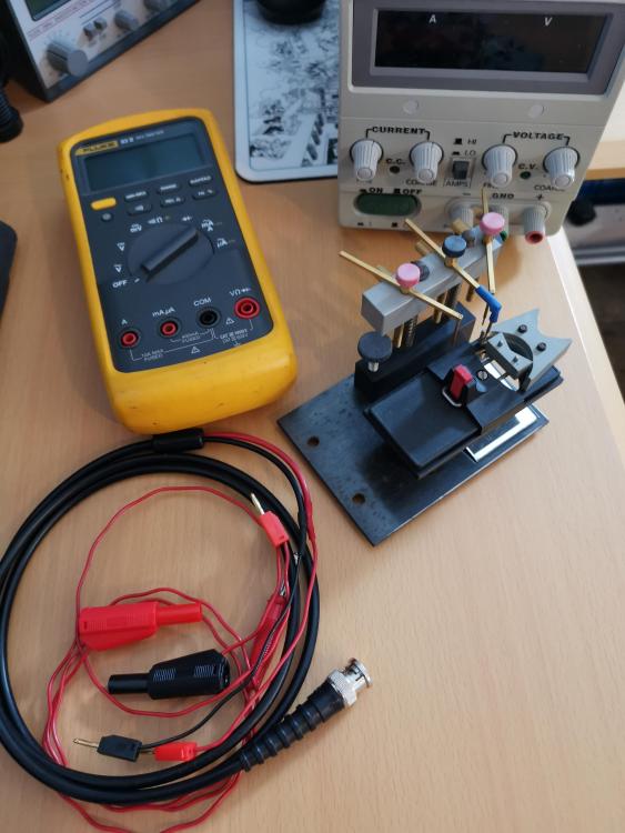

I used a Fluke 85 for the current measurement in line with the power supply. However, I did find a nice vintage movement holder by Portescap and I had to make some test leads for it - both for the multimeter, psu and scope (optional). I'll upload some photos later. I think I have the service manual for the Bulova too if it needs scanning.

Here's my kit, everything second hand bar the psu - I have a Fluke 83V not an 85.
I haven't set it up but you get the general idea. I'm going to work on my 9162 soon so I'll take better pictures then.

This is how I test the ESA 9162 oscillator module. I'd love the Omega Deltatest set up but I've only seen it for sale once on ebay and it was too expensive for me.
I'm guessing I could use a similar method for the Accutrons but I'm yet to own one.

Did you build that movement holder?
No, it's a commercial one. It was made by Portescap who I think are/were connected to Incabloc somehow. I believe it was part of a testing set up from the early 80s but there was more to it than just the holder - I have seen it in an ad on the awci's HT archives.
I just got lucky on ebay, I'm pretty sure I paid less than £10... the seller put the price up on some oiler stands that I was interested in after I told him what they were worth, so I bought this from him instead!

Well it is very nice...jealous.  I may have to build one but I would rather not!
