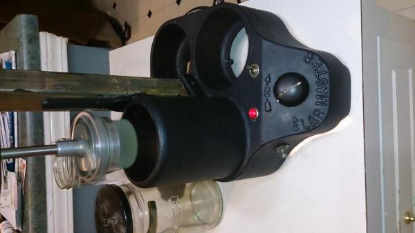

My latest acquisition. It seems to be working great. Now I have to order some cleaning a rinsing fluid. However, the star baffles were missing and the gentlemen is going to look for them. He isn't sure where they went. I'm searching on the bay. Any other ideas? Could I fashion some out of something? If so, does anyone have the dimensions?
As always, thank you for your valuable time!
Gary
The star baffles sit in the bottom of each jar and are just folded stainless sheet. You seem to have the vertical pieces which would be more complex to make but the stars should be easy. I can post a picture of mine if it helps.
Cheers, Chris
Sent from my XT1039 using Tapatalk

For the last several weeks I've been browsing the auction sites looking for a cleaning machine. This one caught my eye, especially since it has all the glass containers included. I just couldn't resist. So I bought it. It should be here some time next week. The seller claims it is in working condition, but it needs some cosmetic work. I really can't complain since it was less than $100.00 including shipping charges.
This picture is from the seller. I will post some more when I get it.
As you can see the paint is in really bad shape, but I have several cans of "hammered" finish paint in the garage. I can finally put those cans of paint to good use. Very exited about this.
