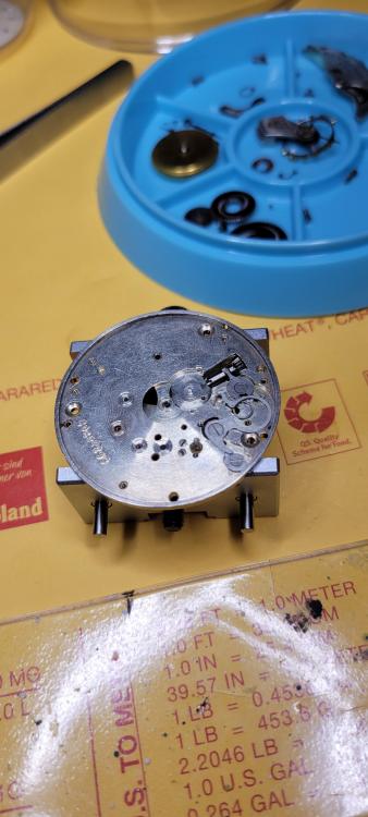

Got this guy off eBay to practice on before moving on to cleaning and lubricating a nice Elgin pocketwatch I have. Thought I'd share my progress.
I got the hands off without issue, then dressed up my screwdrivers and loosened the dial retaining screws. Two of them backed out no problem, and one just spun in place. I decided to take the movement apart from the back and see what I could do.
It didn't come with a crown attached, so I carefully let down the mainspring by holding the winding wheel with pegwood and pushing the click aside.
After that, disassembly was uneventful, other than everything being positively caked with crud. Every screw thread was totally gummed up.
Also, thank you to the YouTube creators out there, without whom I'd never have known the crown wheel screw was reverse-threaded, and probably would have snapped it off.
Finally, I was able to sneak the tip of an X-Acto knife into the hole for the last dial foot and ease it back out, when the dial kindly fell off for me.
And here's where I'm at. Next is closer inspection and cleaning. I have a 10x loupe, but it's inexpensive and I'm currently trying to decide between a couple of nice watchmaker's loupes, a stereo microscope, or a video microscope.
Maybe a demagnetizer, too. I have one of those square ones that you pull the tools through, but I cannot for the life of me demagnetize my tweezers. I mostly used the carbon fiber tipped ones and pegwood to move things around.
It also looks like I'm going to need a new stem and crown if I'm going to wind it up and test my work when it's done. Looking forward to that!
Typically on American pocket watches the crown comes in the case. Then the preferred method of letting power off would be to use a bench key. I'm attaching a photograph typically that come in a set of three.  There are some other variations of how they come but typically this is what the look like a series of squares that Correspond to the typical American pocket watch sizes. Because the cases were made by other people there does tend to be a standard for how big the squares are.

I started reassembly, and am learning to use the oilers while I'm at it. Slow and steady.
I wanted to pull the bottom balance cap jewel. I carefully took both screws out, then pushed out both jewels with a piece of pegwood. Does it look like someone tried to push the hole jewel out the wrong side at some point? Or maybe it took a hard drop? The edges are really chewed up, and I would guess there's supposed to be a little ledge for the jewel setting to sit in?
The cap jewel has a little chip in it, but since it's out at the edge I'm thinking it'll be okay enough for this practice movement. I put a wee drop of 9010 on the center of it and carefully reinstalled.
Then I got a start on the keyless works, and here's where I took a break and poured a glass of Scotch.

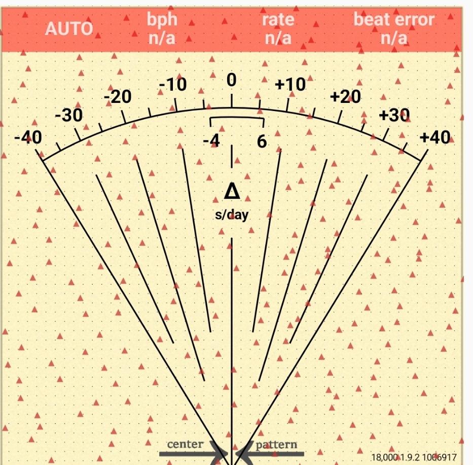

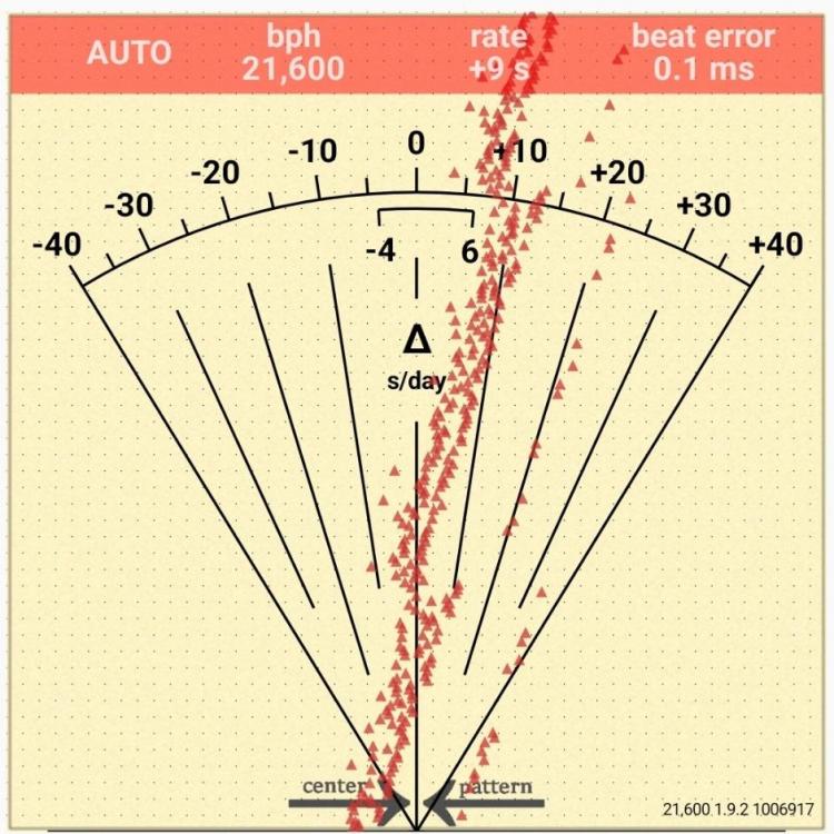

I don't have a timegrapher, so a phone app will have to do for now. After a little regulation...not too bad for my first try!

I know it's a phone apps so I'm supposed to ignore certain things but the surviving patient isn't ready to leave the hospital yet? It be nice to see a running watch that you haven't serviced on your timing app because otherwise the lines look a little on the rough side in other words there supposed to be parallel straight lines not what were seeing their.
Out of curiosity how did you lubricate the escapement?

heh, no doubt. I only have two other mechanical watches on hand, first another Ebay Elgin 345 that I haven't touched:
1344959936_Screenshot_20220107-184314_WatchAccuracyMeter.thumb.jpg.1adf9e616cf904aea29607512f7973ce.jpg
Nailed it.
Then I've got a Majesti 17 jewel made in China watch that my wife got me from Sears many, many years ago. I know it's losing several minutes a day.
