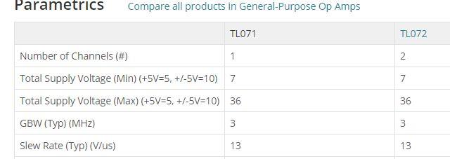

The internal opamp in the Chinese mics needed voltage >7 V according to its datasheet, but seems they use a more modern one now, running from 5 V, too.

Then what I find interesting is if you find a part made by multiple of manufacturers a lot of times you find that the specifications aren't always exactly the same for the same part?  so right now I was looking at a tech sheet first one was interesting shows the +6 V with no clarifications? Then on the same tech sheet it shows plus and minus voltages with + -5? Then the TI sheet makes a clarification which is you can have differing voltages for the plus and minus as long as the total is 10. 10 is considerably higher than the Chinese 5.91.
then back to the TI data sheet and noticed what you have above which is very very confusing. So the minimum says (+5 equals 5, +/-5=10)  then there is the number 7? So we get a plus minus voltage situation the total has to be 10 but here it says the minimum is seven?
It's really a shame they didn't go with one of the modern op amps that's designed to run a lower voltages and a lot of them are low noise or lower noise. so as I have the microphone and Monday hopefully another USB adapter shows up I'm going to try at 5 V anyway because I can.

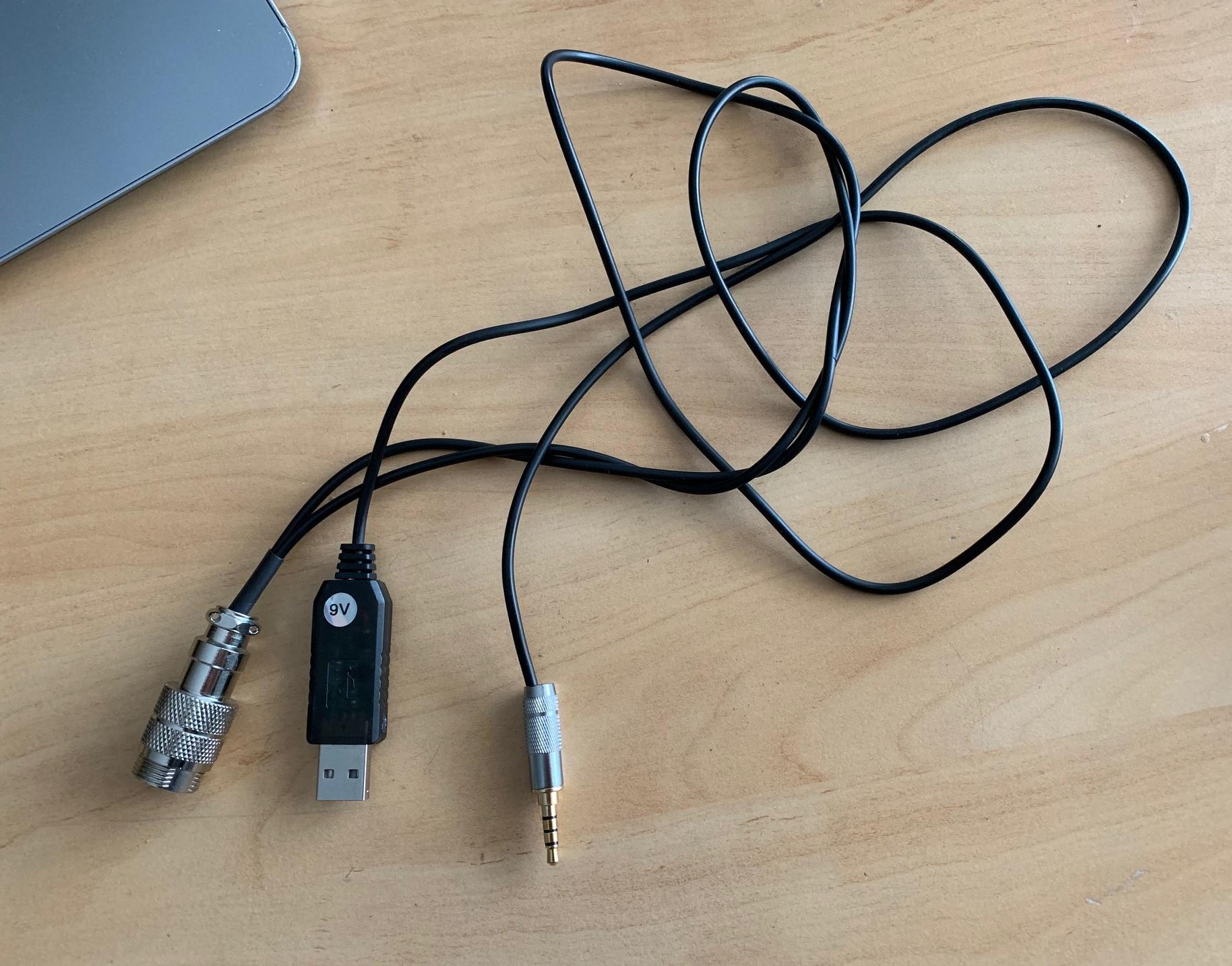

On my Weishi No 1000 timegrapher, the preamp uses a Ti 2272C, wich is powered by +8V.
I bought a DIY adapter for Weishi microphone and PC, in order to have the benefits of Weishi microphone stand and graphic display of TG software.
-With Weishi microphone stand, I like to test the watch or the movement in all positions, safely.
-With TG software, I like the details provided by the PC screen, and to "see" the sound from tic toc
The adapter has an USB powered 8v power supply, a TRRS microphone jack and an XLR connector for the microphone.

Check content above. The connector on the Chinese timegrapher is not a DIN neither an XLR, it's an "aero" type.. And you need a 9V source, most practical is from an USB upconverter.
Does it need 9V, or can it run from less?  While the pre-amplifier in the cheaper 3d printed microphone uses a 9V battery, it should be possible to power it from a wider voltage range of 5 - 12 volts.  I tried powering it directly from USB and it seemed to work fine.  Maybe the 1000/1900 microphone works with 5V too, which makes things easier.  Direct USB of course, and also one can readily get usb chargeable batteries with 5V output.  Typical power bank or a board like https://www.aliexpress.com/item/4000200690185.html  USB to 9V exists too of course but isn't nearly as much choice as 5V.

It contains a TL071.
But iirr newer version use a more modern chip that can run with lower supply voltage.
Try what works or open the case and check which type is inside.

Yes, the IC used in there supports a voltage range, but 5V is outside specifications, that's why you need an USB step up, easy and cheap for $2. https://www.aliexpress.com/item/4001081594055.html
