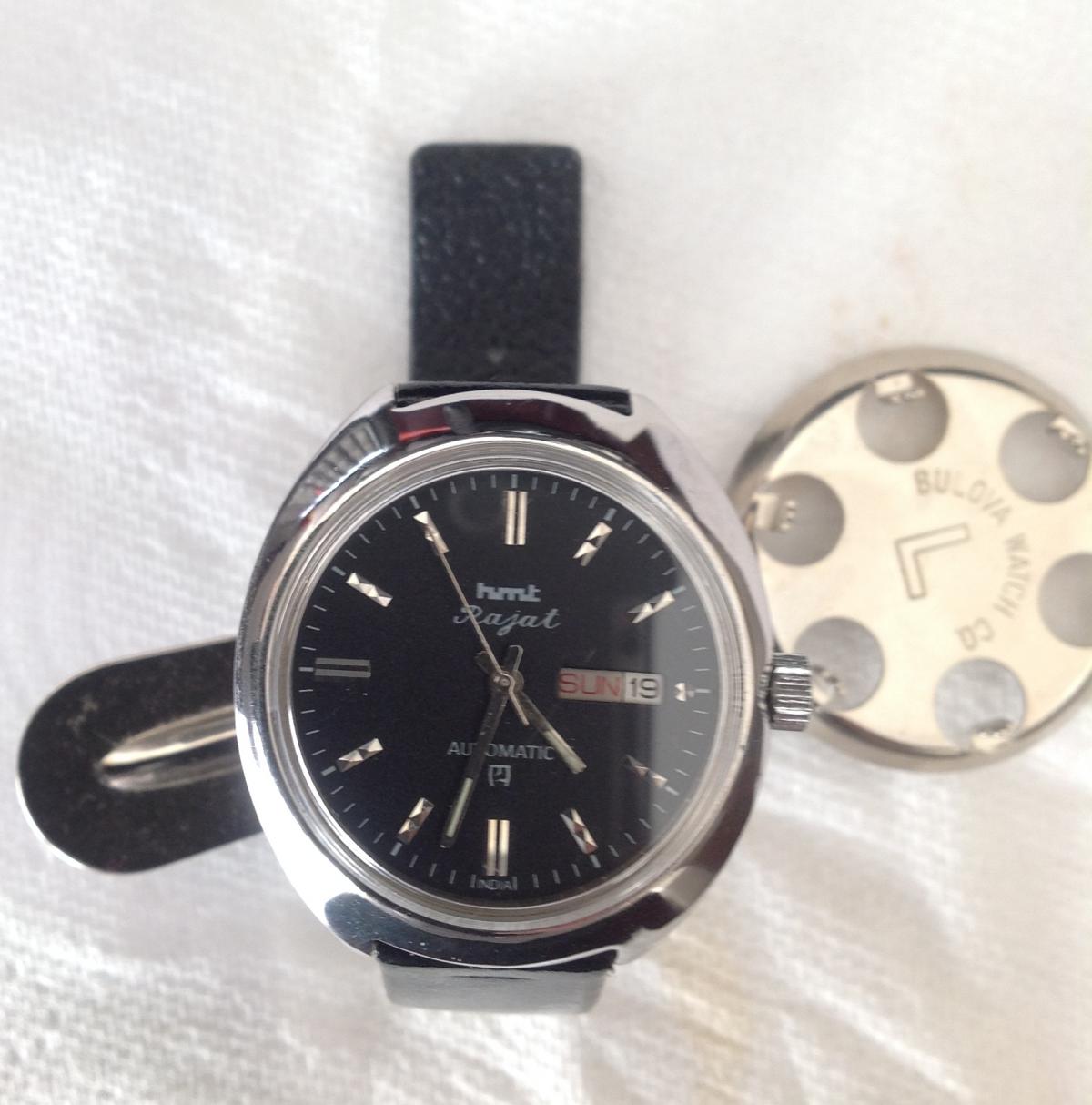

I have this HMT Rajat. Automatic. Looks spring not winding. But if I wind manually it works fine. Any guess what must be the issue?.post-911-14388331123383.jpg

Hello Sendi,
I am led by your description of the fault to the automatic wind system.
With the back off check the movement on the oscillating weight. If the weight is not turning freely then that is the problem.  It is unlikely to be catching the case as in general these movements are much smaller than the case. There is a ball race that sometimes causes problems and if that is faulty or dirty will have an effect.  When you gently move the weight the wheel just below centre should turn and that transfers to the spring, if it does not turn there is a problem between the two. If none of the aformentioned is at fault, It is really a case of removing the bits of the auto winding mechanism one by one checking as you go to see everything meshes correctly and all the teeth are ok.
Good Luck,
Vic

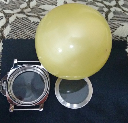

I have got this case from eBay shipped from Hong Kong in 7 days it reached Bangalore by normal post.
I have sea-gull hand wind movement which I am going to assemble with this case along with hands but without dial.
I don’t have case opener for this 12 edge case back forgot to check while ordering. Case opener for Breitling can be used.
But It is very expensive it seems.
Is there any suggestion where do I get a low price one? Or any other tool can be used.
Pictures are taken from eBay item description and used as it is.

You can get ebay cheap openers for that case. I did and they work :) They are made for ETA 6498/97 and its clones from different places. There is a ring you will need after the movement is in place and before the back is on secure the movement inside. Those rings are also ebay purchase but I found them to be very expensive.

That's a copy of a Panerai case, so search for Panerai opener on eBay. There's chinese copies available for $20 each or $70 for a set with 4 sizes.
Also, the cheaper ball style caseback opener usually works for those.
Now I am in confusion it needs mounting ring or clamp is enough.
It should only need the tabs and screws to secure the movement.

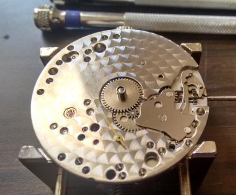

I just too this Chinese 6498 movement to start my assembling with the case. Hour wheel I got from a hong kong eBay seller. looks there is some issue. with Cannon pinion both are in same level.  Or they are fine?
Edited by Sendilkumar
Looks too high to me.
I would suggest that you source the dial you are going to use and then you will know if the hour wheel is too high, or the cannon pinion is too short.
I think that cutting the hour wheel tube a bit will enough. Should be possible, although not professional, even without a lathe.
