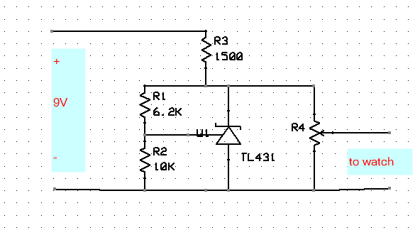

His circuit is overkill IMO. I have not read or tested to confirm, but I would expect almost no real current drawn by a watch. Therefore the source resistance is no big deal. Using regulators to achieve 0.001 ohms source resistance is not necessary. What is important is an extremely low ESR capacitor in shunt with the watch.
I am planning on using a shunt regulator and a resistor divider with a pot...a very simple design. At least, that is where my head is now.
Another thing I learned from the docs is the need to go all the way down to 0.8 volts.

Strategy change.  For now, I wanted to have a variable voltage source to power watches.  This is not integrated with anything.  Just a standalone voltage source with readout.
That is a 10-turn pot, so I can make fine adjustments (though that is not necessary).
Not the best 3D print, however.  My printer has been giving me a few fits here of late.
