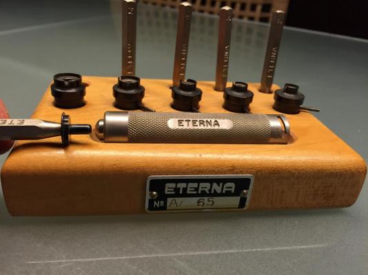

Hi,
This is my first post on this very instructive forum. More than a year I read almost all posts.
Together with the wonderful videos of Mark I dare it to disassemble a watch and more importantly, to reassemble.
At an exhibition I thought I had bought a mainspring winder, but between the hook on the winder and the edge of the barrel is too little space for a spring. The disc fills almost the whole barrel. Only little torque can be given due to the absence of a handle. Can someone explain to me what I can do with this watchmaker tool?
Kraai
Welcome to the forum Kraai.
What you have here is a set of mainspring winders. They are not the usual crank wind Bergeon type, but very similar. Instead of the cranks, you have a set if handles that are hexagonal in section that are used for the actual spring winding.
To operate it, you select the correct size of spring holder for the watch barrel and fit it to the large knurled handle. Now use the appropriate hexagonal handle to wind the spring into the holder. Once the spring is fully wound inside the holder, it is ejected into the spring barrel of the watch by pressing the button on the top of the knurled handle.
Thanks for your reactions, but when you take a closer look at the images you will see that the hook is on a small part of the arber in the "normal" winder. However, in the "unknown instrument" there is very little space between the hook and the outer rim of the barrel. In these pictures the diameter of the barrels is more or less the same.
