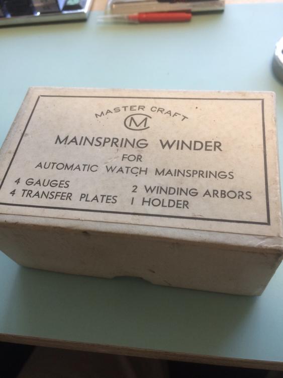

If it is the same winder as my one I found that the hole/slit was too small to allow the the spring(especally auto springs) to fully load into the retaining barrel. So I filed a little to make this hole bigger and they now work fine.
However I normally use my "mastercraft" winder which I find easier to use.

I have the Bergeon Winder 1/2 set but had to modify it to work. i found the hole that accepts the spring when winding galas too small. However if you see a Master craft winder I recommend you purchase.  See pics to see how it works.\5b2fe74351f56_Mastercraftwinder.thumb.jpg.a170fed4120e63f5efa96d1c4324f8f4.jpg5b2fe744b0551_Mastercraft1.thumb.jpg.0bf8f0b9db61c1105208a4cd2492c736.jpg5b2fe745d4f00_Mastercraft4.thumb.jpg.6da4bfc582ea837a9c06180b65bc3724.jpg5b2fe7470eabe_Mastercraft2.thumb.jpg.3f9b83a34c68efffa9f8088b008649ca.jpg

(---)However if you see a Master craft winder I recommend you purchase.  See pics to see how it works.\
1
That looks great! Can I buy yours, pretty please with sugar on top? ;) I'll save a search with notifications on eBay right now. Any other sites worth searching?
