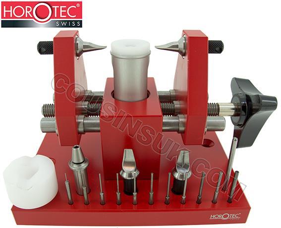

This press:
https://www.cousinsuk.com/product/press-robur?code=G0728
with this set:
https://www.cousinsuk.com/product/die-set-robur?code=D0425
is probably the best, but expensive. They are cheaper second hand on ebay but not by much if two bidders are keen.

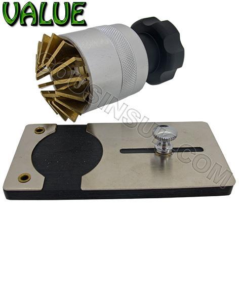

Plato thanks for your post though I do not need that since I already have a press & die set.
I need the opposite of that.
Again, I would like to know "how to remove the crystal with a metal rim wrapped around it"  that was previously pressed into the watch from above (using the press & die method).

The watch movement is set into the case from above and in order to replace the dial's hands the top crystal needs to be removed to gain access. The movement is not designed to come out the back.
There is this tool that I just happen to find doing an online search.
https://blog.esslinger.com/how-to-remove-a-watch-crystal-with-crystal-lift/
...and then there is the following method below but I am real hesitant to even think about going that route?
https://blog.esslinger.com/how-to-remove-a-bezel-fit-watch-crystal-with-a-bench-knife/

Ok, I thought you wanted to remove an armoured crystal. To remove a bezel, just a regular case knife will do the job. Upload a photo of the watch just in case it's something unusual.
Thank you "Littlewatchshop" & "Nucejoe" for your recommendations on the process and what to use.
Yes, I started the process off using a Single Edge Razor Blade (very carefully) which helped a bit but soon found out that I needed something with a better grip / handle on it and well used my fancy customized (has my initials on it) box cutter to follow up on the process.
That did it for me and was successful to remove it.
Live and learn.
I just wish that there had been an easier way to this process or at least a specific tool to use.
Here is a picture of the type of basic straight edge razor that I used to start the process followed up along with my customized box cutter to actually complete the process.
