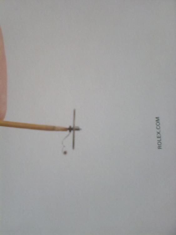

Out of materials of your choice, I make several  golves to pull over a flat wooden ice creame cone, to use as brush on pallet jewels, Your one directional strokes of the brush is A okay.
Sorry ice cream sticks not cones

I stick pivots into pegwood or cut the tip of a tooth pick with nail clipper to stick the pivot into, rotate the tooth pick " not the pivot"  repeat , best to soak the part in your cleaning solution.  If the shock system lets, remove the jewel ,enter the tooth pick inot the housing, in which case I rotate the wheel. Soak and rinse again.

Last year endevour run out of idea, liked and used my tooth pick technology:lol:
he then posted the pix on some tutorial thread , I thought he done post, no need for me to bother. Here we are.
You can unlock shock springs, pop the jewel assembly out ,into a jar, stick a tooth pick onto pivot, turn the BW, this pegs the hell out of the pivot. Repeat .
Good luck pal.
I actually prefer toothpicks for pegging jewel pivots as they are somewhat softer than peg wood.  You can develop a sharpened tip with sandpaper or a fine file.  I do sometimes use peg wood as well though.
I use naptha as well in the ultrasonic.  I run thru three separate naptha baths and pith the pivots on wheels, the pallet, and the balance into pith wood for cleaning between bath number two and three.
It works for me but use at your own risk.

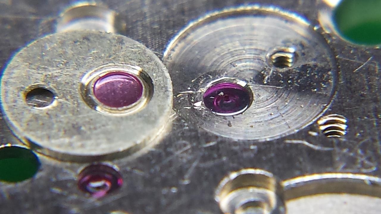

I picked up a movement from Ebay to tinker with, I think it’s Derby 40. I only have experience with incabloc and this one puzzles me. There is a balance jewel and an endstone but no shock spring so why the endstone?
To clean and lubricate the jewel it looks like I’m going to have to remove the hairspring.
Any tips, threads, articles or videos lubricating this?
Open "boot" on index pins. Loosen stud screw. Remove balance. Remove two screws on underside of balance cock to remove cap jewel.
Oil drop should cover around 50% of the cap jewel. Refer to BHI document.

I don’t know how you open the boot. My plan was to loosen the stud screw and slide the hair spring through the boot and index pin to remove it but looking at the picture the hairspring doesn’t go as far as the stud. I’ll have to have a good look at it at home, admittedly I never took a balance apart and I’m not sure how it is actually attached and I can’t see it that well from the picture.
