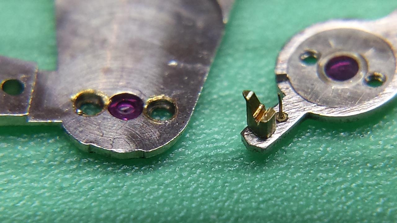

My cleaning machine is Elma (Elmasolvex SE), a mechanical cleaning machine. Mark L. recommends to clean in the machine the balance complete (installed on the main plate) with the upper and lower jewels (including caps) mounted in their Incabloc blocks. The reason given is to protect the balance pivots during the clean & rinse cycles. Later the jewels would be disassembled, cleaned in a One Dip, oiled, and reassembled.
But this procedure will almost ensure that the balance wheel pivots will not be cleaned because they are sitting inside their respective jewels, nor will the Incabloc blocks get cleaned because the chatons are sitting tightly inside them. Nowhere could I find how those would get cleaned later. Is this something to worry about?
They would get full cleaning if the jewels were removed prior to going into cleaning basket. But then, how about those pivots? Would they really get damaged? What works best?
I have always cleaned any watch with shock protection (Kif, Incabloc etc.) with the balance and cock on the mainplate but with jewels out. On watches with no shock protection the balance comes off the cock, cap jewels off, everything cleaned disassembled. I've used both machines that agitate (spin) and ones that don't, and have never damaged or broken a pivot during cleaning. We were taught this in school.

Thank you! This procedure would work  great! I am happy to learn that my fear of "unprotected" pivot damage was not supported by the experience and the courses you took. I will follow it in the future.

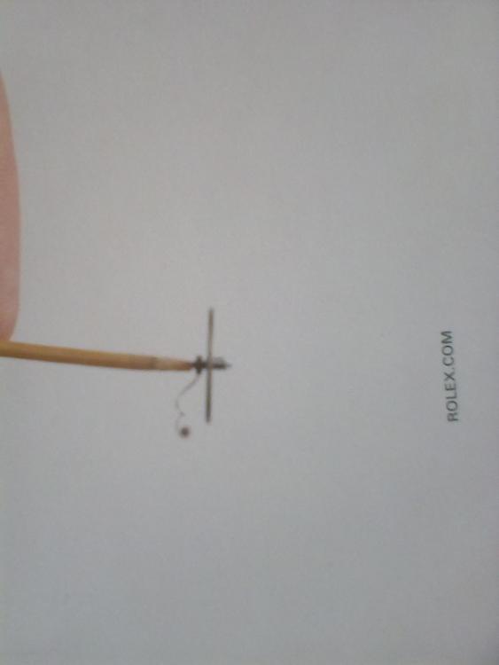

I use a nailclipper to clip off the end of a toothpick, stick the pivot into the toothpick and turn.
If you have removed the jewel and endstones, raise the shcok spring stick the toothpick onto the inside the housing.
Ready for cleaning machine.
