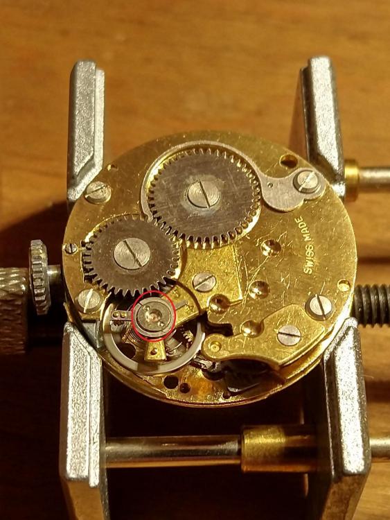

Hi *,
I am practicing on scrap movements after failing on a couple of projects. Every time i brake off a screwhead (this is how my Christmas present to my Mrs ended up too) at the end of the cleaning process during re-assembly i just sink into the carpet next to my lost movement parts and it takes me a while to appear again. So now I have this movement on the picture and I am confused as always. First of all if it says AS 1228 should i not be able to find this movement on ranfft for example, or on any other site, i seem to fail to find it? And secondly I cleaned and oiled everything apart from the balance jewel, because the plate which holds it in place screwed from the hairspring side. How do you clean and oil this jewel? Do you have to remove the hairspring? (When I type hairspring down I am jumping into the air, i have nightmares about hairsprings.) I would normally google it or read about it ,but i don't even know how to phrase my search text.

This is a fiddly job if you have never done this before, so it might be an idea to practice on a scrap movement.
The cap jewel is a non shockproof type and will need to be unscrewed from underneath the balance cock. You can see the end of those screws in the picture you posted. First you will need to take off the balance cock from the movement and carefully turn it upside down, making sure the balance staff pivot is sitting safely in the jewel hole, Then turn the 'boot' which I have marked with a red arrow 90 degrees, so the hairspring can be released from between the boot and the curb pin. Do this with a very fine screwdriver, as there is an indentation in the boot to do this.
The friction fit stud that the end of the hairspring is pinned to with a tiny brass tapered pin. I have marked this with a red circle. This stud is held in place by friction, by the looks of your picture, rather than a small screw coming out from that arm and will release with downward pressure on the top of the stud in the picture. The arm that the stud fits into will need to be supported in some way to do this, usually using a staking set to do this if it is a really tight fit. I use an adapted tool that pushes the stud and holds the underside of the arm at the same time.
Once the stud is free and the boot moved 90 degrees the hairspring and balance wheel are free. You can then undo both the screws on the underside of the balance cock to remove the cap jewel to be able to clean and oil it

I was worried that you would write something like this. In this case I go home and will have a go with it. This time i am going to try to spend less than 5 hours to try to bring the hairspring back to its original shape after I twist it and bend it accidentally before i put it into the bin.  Thank you for your time. I am going to take pictures as I go and upload here.
What Jon has said is the best option and the only way to clean it correctly.
If its not too gummed up with dirt there is a less scary way to atleast oil it which is better than nothing whilst you are still learning.
Place the balance upside down and carefully lift the balance slightly, not too much or you will damage the hairspring.
Now with your finest oiler place a drop of oil directly on the pivot hole without putting oil on the hairspring else you will need to clean it all again and start again.
Next using a very fine wire, or a tool like this
https://www.cousinsuk.com/product/oilers-3-in-1-incabloc-specialist
Poke the fine wire into the pivot hole so it touches the end stone. Capillary action will draw the oil into the pivot hole oiling the pivot.
This is not the preferred way to do it as you haven't cleaned out the old oil, but consider it a stepping stone until you feel confident doing what Jon said above which is the best way to do it.

Thank you for this, this is what I have done, but unfortunately I think i also oiled the hairspring a little bit. So yes I have to start it over again, however I want to do a proper cleanup for two reasons. First of all i am doing this for my pleasure and I want to learn, secondly the movement stops ticking immediately once the balance staff sits on the jewel if i flip it over its running smoothly.

I managed to oil the cap jewel as instructed. I removed the hairspring from the stud instead of the stud from the arm. Is that a bad practice? The movement does not really run though, well it runs only in face down position as the pivots of the balance staff has a T shaped head and one of them even seem to be a little bit bent. I would need to try to polish the pivots what I have never done before, not even sure if it makes sense with the balance staff or to replace the balance staff. I am still happy though. I managed to clean this movement, then put it back together, oiled it etc, no broken screws, twisted hairspring, broken pivots, lost parts.. :) And most likely I found the fault in this movement. Ahh I even made a new hook for the mainspring as it was broken. :)
