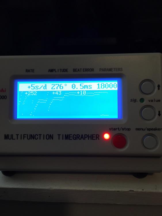

Hello everyone. I’ve recently serviced this Elgin grade 347 and it runs well but after a few minutes the rate jumps up to a few minutes fast per day for a few seconds and then back down to 0 seconds per day runs fine for awhile and every now and then sporadically jumps up again. Hairspring sits between regulator pins not hitting anywhere and all seems fine. In 24 hours it’s usually 30 seconds fast per day. I think it does worse right after winding.any help is appreciated.EA0DCC85-7A02-4994-B14C-E24D70547AE9.thumb.jpeg.99e3440d400fd8f2b693f6f35b59076d.jpeg1DD6AF73-A6EB-4809-BE40-6A90F5CB8A1B.thumb.jpeg.7cb55b00ae47ce746dcd557a30239cd0.jpeg689B68C8-4CCA-4ABC-9853-4019990C0AE5.thumb.jpeg.2d6c09865e3e94e7213edd8231e9ba00.jpeg
How far apart is " sporatic"    perhaps your observation on TG hadn't been long enough to see a period of occurance.
I make a habbit of checking how the movement runs on TG before and after  installing the dial and hands.
Regs
Thanks, Nucejoe. I rechecked the movement on timegrapher and realized that every 5 minutes it was still jumping minutes fast per day. So I decided to take a better look at the train and found some slightly damaged teeth on third wheel and fourth wheel pinion where they meet. I counted teeth and pinion and luckily had spare parts so I went ahead and changed all train wheels except for center wheel and now the watch is staying running steady and strong. This time I left it on timegrapher for 20 minutes and no problems.👍amplitude also improved some. I figured this information may help someone else with this.4BC22CFC-947F-4A91-A2E9-DE75C4A7CAE3.thumb.jpeg.0717255d6e0ec8816d576e94138543f2.jpeg
Even though you fixed all your problems I'm still going to comment a few things. So initially you're describing something that looks exactly like Rebanking. I have a link to a video which explains basically of too much energy when the watches fully wound up. This can sometimes happen with variety reasons or if the mainspring is too strong which can happen on American pocket watches because we don't have the choice of mainsprings that we once had. Typically today one size fits all but one time you would had several different strengths for your pocket watch.
https://youtu.be/Rcqrb3_vin8
On 2/20/2022 at 12:30 PM, Crockpot said:
It was the regulator pins. They were too short. Making the hairspring slip out from between them and pop back in place hence the weird results.
There's nothing that says that you can't move the stud up a little so that the hairspring stays between the regulator pins.
This is where either a different timing machine which is very expensive or the old days of the paper tape machine was better. Because of the paper tape machine you can run enough paper tape to try to find a pattern. It's harder to find patterns on a liquid crystal screen when you of a limited amount of time. But you do watch the numbers go up and down and see if you can find a pattern.
